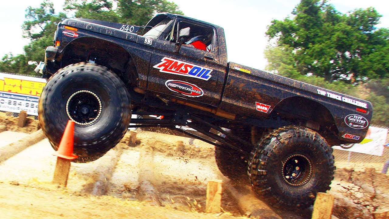

It's big. Will it be too tall for top truck challenge? I don't really know, I don't follow many competitions.
Martin
Should be fine (maybe even on the small side), for comparison the Ford is on 54's.
The only place I truly worry about how tall/top heavy they get is in the canyon in the Tank Trap. That wall loves to eat A pillars.
After watching this years TTC, we aren't planning on taking this truck there anymore. If we do it will be a different truck... something with a shorter wheelbase.
