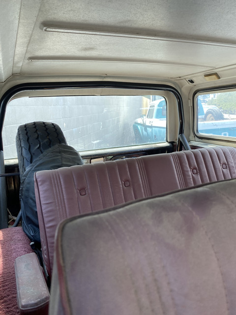

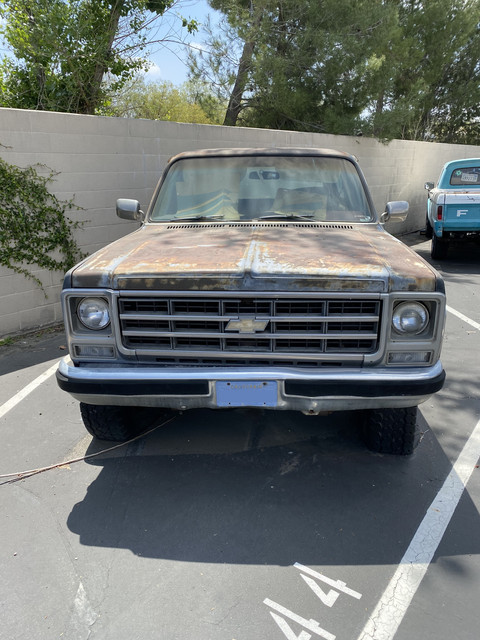

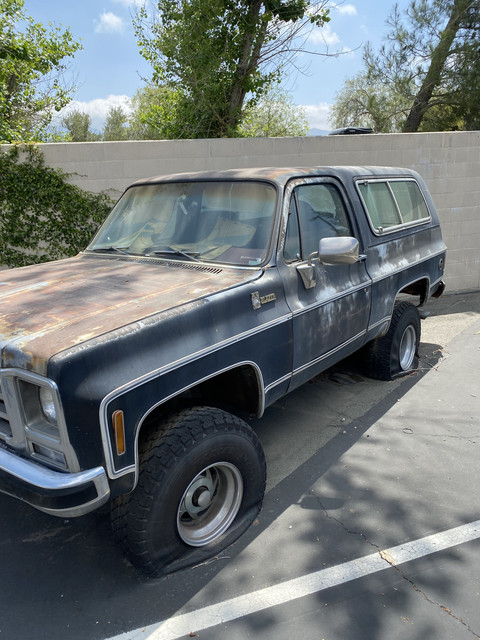

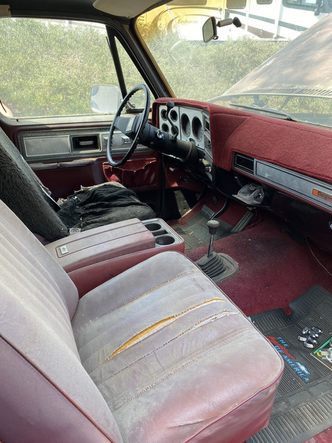

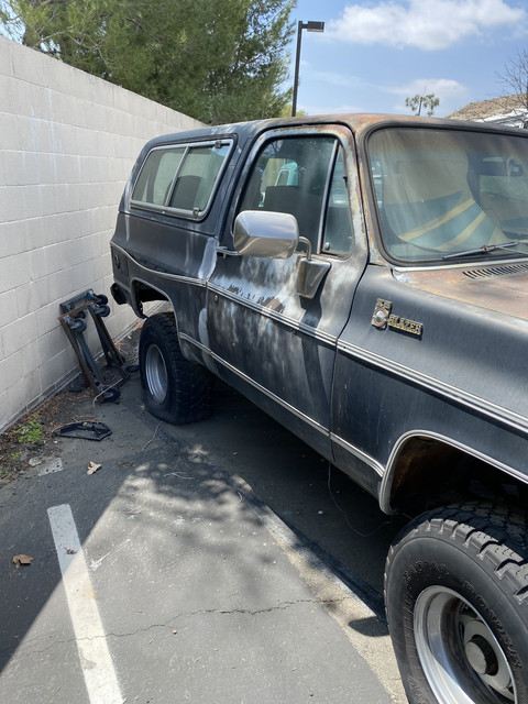

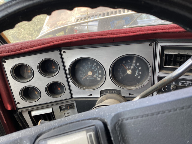

Hello,
My name is CJ and I am new to the forum. I joined because I just inherited a 1979 K5 Blazer Cheyenne from my dad that recently passed from covid and I am not sure what to do with this car. By all means, I am not a car enthusiast. I remember riding in this truck as a small kid ( I am 27 now), So, it's holding some sentimental value.
Some facts about the truck:
  • It is currently stored in an outside storage facilty parking lot under the sun in Southern California.
  • The truck has not been driven since at least 2005. Hasn't been moved since 2005 presumably.
  • I have the original equipment/factory window sticker and owner's manual.
  • See pictures attached on the current condition.
My thoughts and questions:
  • It would be really nice to get the truck running (AT the very least). What would it take and what kind of cost would I be looking at?
  • As much as I would want to keep the truck, I think it would be unreasonable for me to try to restore it and try to sell it instead.
  • What advice could you give me about this truck?
See Pictures and let me know what you think!

I would give it a
1)good tune up an keep it as a Sunday driver
2) new tires obviously
3) wash it, then wash it again an then wash it one more time. have a shop shoot a new coat of clear coat.
or you could sell it as is an hold on to the memories of your late father (my condolences)

I'm sorry to hear of the passing of your father. You've got at least $1k probably in needing some tires and other costs to get it running plus quite a few hours of work that could be expensive if you're not experienced. Body is what it is. Honestly, there's not alot of financial value in the truck, so I think you have to decide whether to keep it for the sentimental value or sell it and move on. I inherited a non-running 53 Willys M38A1 Army Jeep. I spent more than half of what I got for it just to get it running again. Food for thought.
