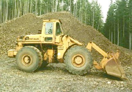

My father had a construction company back in the 70's and 80's that built the subdivisions before any houses and all we did was take a hook like these cut the part off where you put the chain and welded them to the front lower part of the frame in front.
Then on the rear of all our trucks we had pintle hooks.
Both worked great as I had a habit of burying our two wheel drives in the mud. We pulled them out using big Allis Chalmers 745 wheel loaders and never lost a hook!
