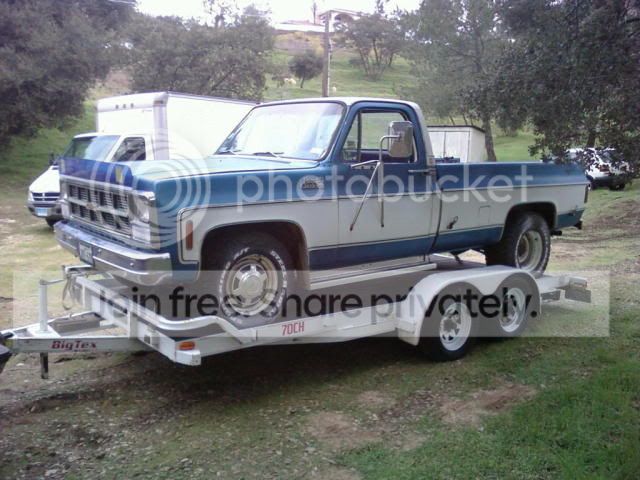

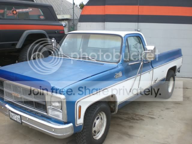

Its just a 2 wheel drive Camper Special which is perfect for throwing a old Lance camper on and getting to the desert. Its just a beater truck but it was FREE!
This is when I picked it up out of the field where it has been sitting for 12 plus years.

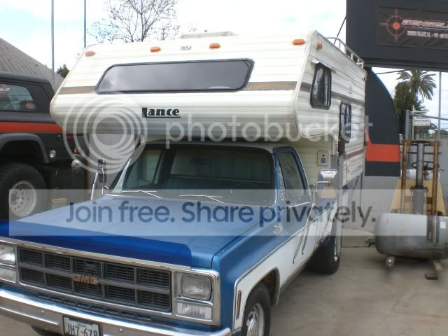

No tach, but super clean interior. Nice fresh engine with super clean oil. I just ran it down to the weight station and it weighed in at 5240 LBS.
I snuck it home and threw the camper on last night. Cant wait to use it now. LOL
