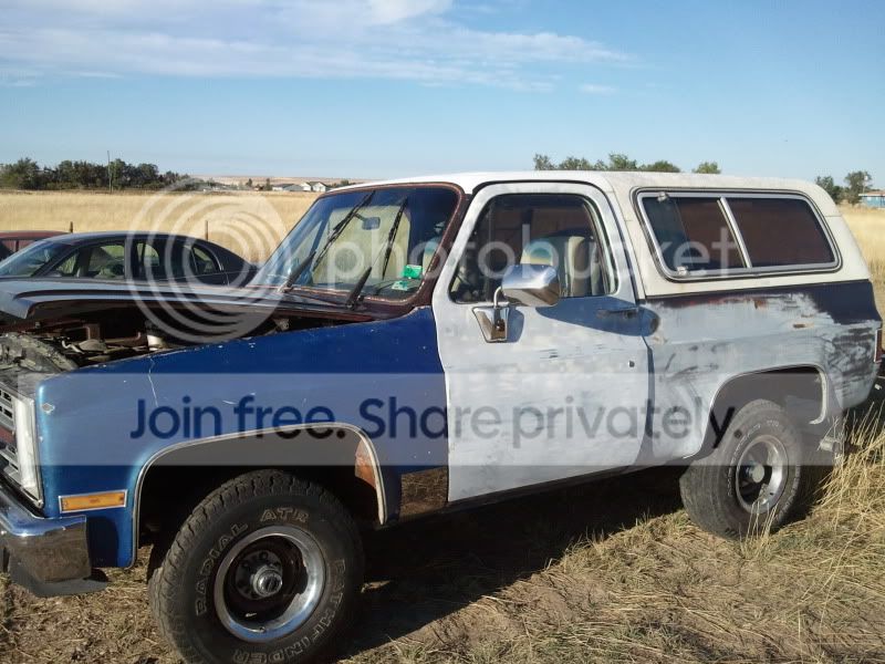

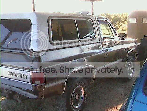

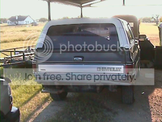

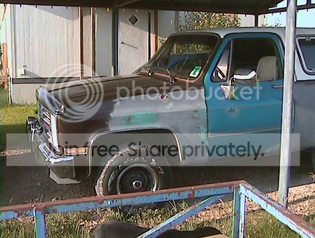

I bought my K5 in San Antonio TX, the summer of 2003. for a sum of $700 dollars.
Here is what she looked like when I picked her up.
The previous owner had been in a collision, and damaged the drivers side quarter, fender, door, and bent the steering wheel. It was a little tough to drive, but I managed to make it the 25 miles home. I made it home and immediately starting puking coolant everywhere. A new water pump and she was good.
No frame damage it would run and drive no problem, except for the steering wheel being off to the right a bit!

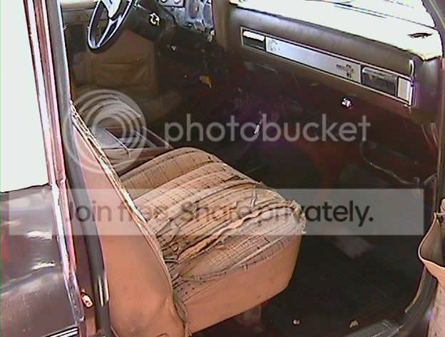

Drove it for a little while doing minor things to it. The interior is shot, needs everything! The rear bumper that was on it, was damaged so I removed it.
Picked up a drivers door with all the electricals in it, replaced the door and threw a coat of primer on it. I also tuned it up a little.

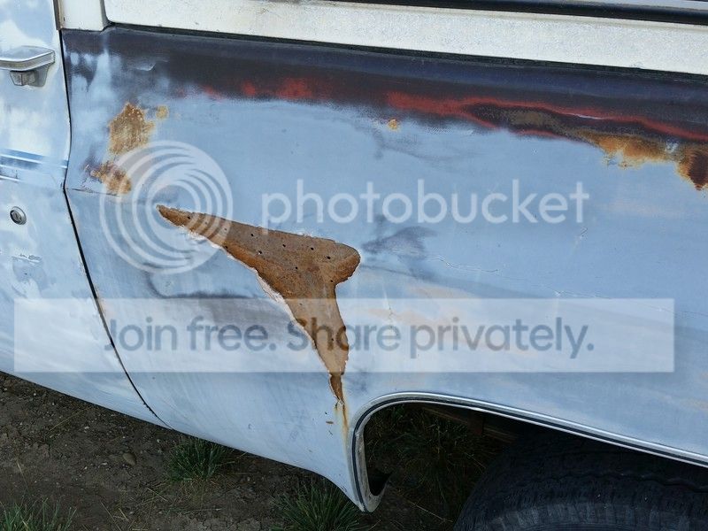

Plannin on doin some small things first. Need to replace a small section of the pass side floor, and throw some paint on it. Just to make it one color.

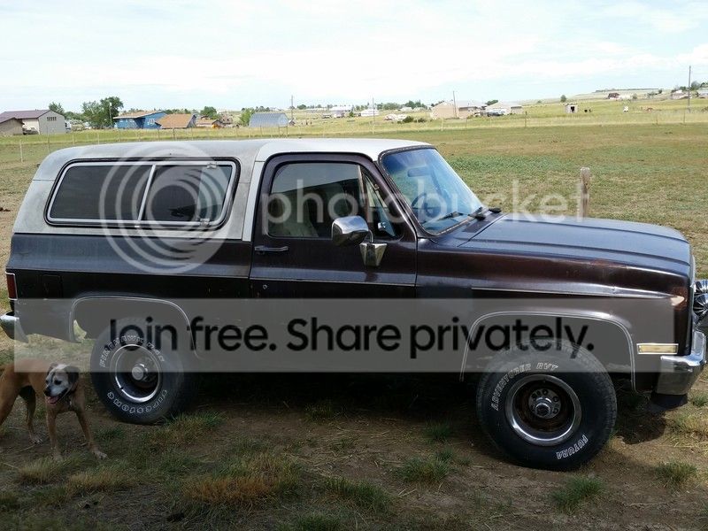

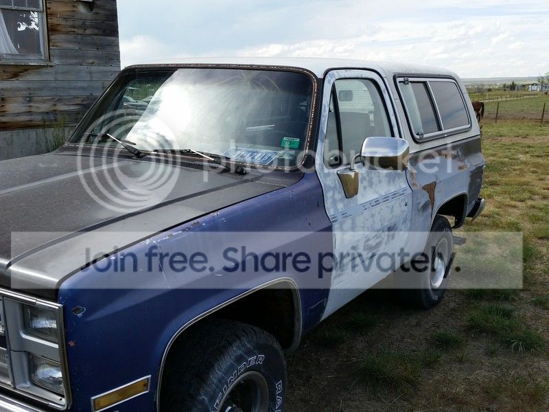

How it looks 7 years later!
So I finally had time to work on here.
The first thing I did was to see if she would run.
Needed to buy a new battery. The batt that was in it, ended up walking away.
I could get her to crank over, but she would not fire. according to the gas gauge, it said that I had 1/2 tank of gas.
Crap!
I ended up dropping the skid plate, then the tank, and finding out that it had about 15 gallons of varnish in the tank.
I drained it (tough job when your doing it by yourself)! Then replaced the tank after ensuring all the lines were blown out and free of any debris.
I threw some good gas in it and she fired right up and ran surprisingly well except for the god awful scream of the power steering pump!
I like the brown paint, I hope you will keep it.
I also like the brown, my major concern right now is to get it one color!

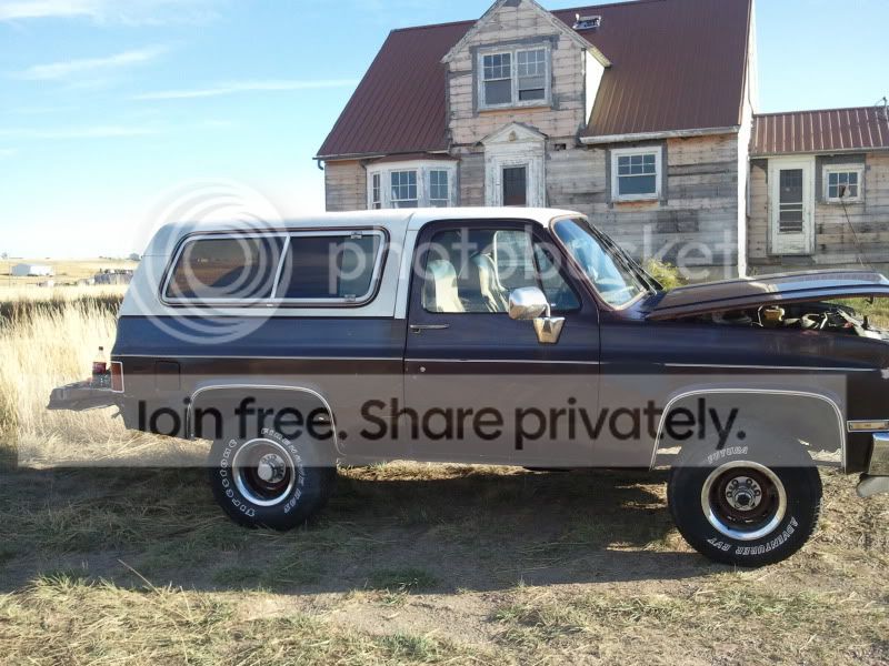

Some more progress.
I replaced the drivers fender, with a decent fender that my brother had laying around. I just can't seem to get rid of blue body panels!
