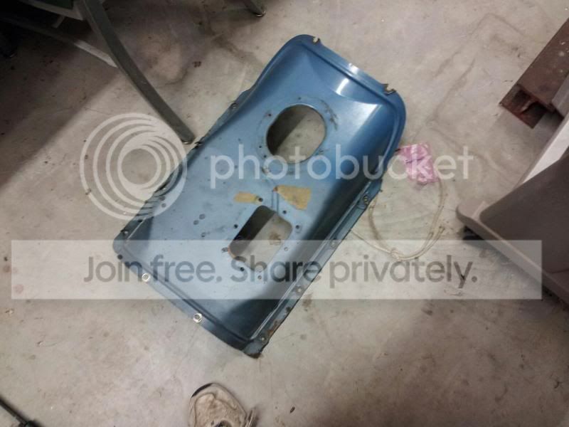

Finally got to work today. Didn't get a whole lot done but atleast got some pictures. I removed the seats, the front carpeting and insulation, as well as the trans tunnel hump. Much to my dismay, the insulation was damp (can't remember the last time it even rained!!!) and under the insulation is what appears to be substantial rust. I've never restored a car before and I've never had to deal with rust however I do possess a stick/TIG welder and i've done welding before (exhaust). I'm just not sure how to proceed with the rust. I've done some searching and reading and most of the threads that come up are pretty depressing. Many people recomend to just get a new truck. I've got no sentimental attachment to this truck but I do have some practical attachment. It's my first car; I coughed up all 1500 bones myself. Also, it has a manual SM465 and a clutch pedal plus linkage stock. This really simplifies the NV4500 swap. I'm pretty sure the rocker panels are gone and I have yet to even look at the tailgate area/bed :(. I really was planning a full restoration but now I'm second guessing that. Anyway, Pics for your time.

Well good thing you put pictures, now a few east coast guys can slap you on the back of the head for calling this rusty :D
For me her with access to cheap vehicles all the time I probably would sell it and get another but in reality this is an easy job.
The floor section is very easy, the door area is a little more difficult but not too much.
Practice with the floor first and then do the others.
This could be a couple of days max.
What you need to do is cut out all the rusted area, and if there is some surface rust on the edges that is still solid and you want t preserve, get some rust converter spray and spray it after cleaning it with a wire brush.
Once you have the area preped get a piece os sheet metal and cut a square piece little bigger and tack it on then put a few stiches all around 1" long each and keep switching areas so you don't overheat one area and warp it.
You can finish it all closing all the gaps, or you can just do enough to make solid then cover it wih undercoating to make it water tight.
