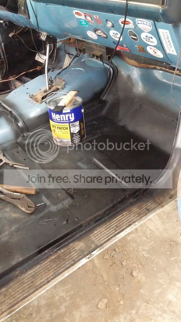

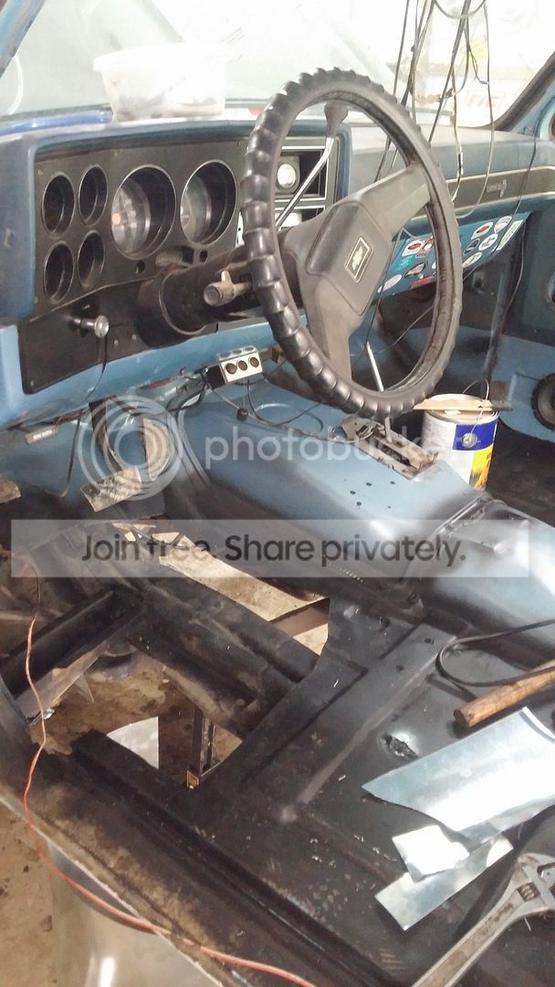

The floor plans are rotted, the body has plenty of rust and really isn't worth saving and I don't plan to. I'll run it till the cab falls off the frame and put another body on it, but for now, I want to seal up the passenger compartment. The last time I drove through a creek crossing, water pushed the drivers floor carpet up to the pedals and soaked my feet.
So I cut out the majority of the rust in the cab out and am going to rust paint it, seal it with stainless sheet metal, roof rubber, and self tapping screws. I know, I've got a little 110 wire welder, but I just don't want to open that can of worms on this thing.

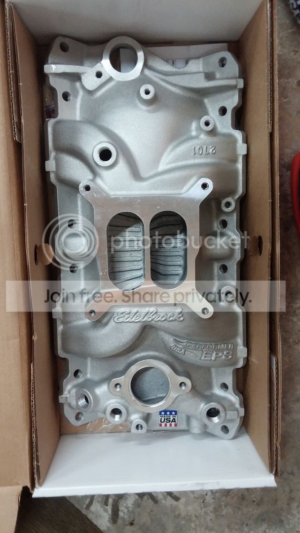

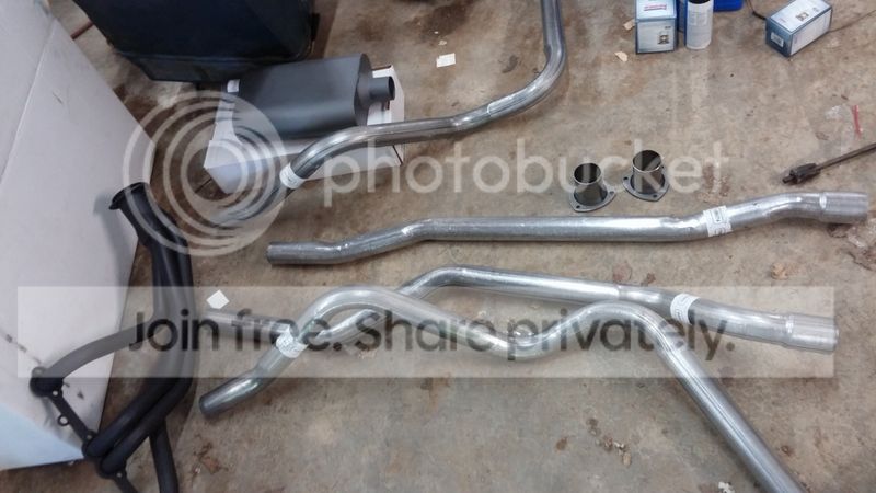

It was originally a 305 truck, but now it has a Goodwrench 350 that has been good to me and actually runs really well. So, I picked up some cheap long tube headers and a 2 1/4" dual system with flow master knockoffs and an edelbrock eps intake along with a hot coil, cap, wires, plugs, etc. Hopefully that will help it out in the mpg and power department. I plan to strip the headers and paint them with some decent high heat paint.

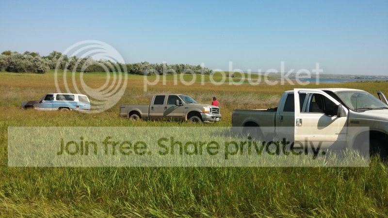

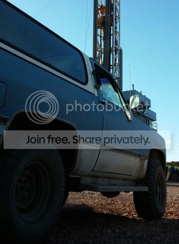

Stuck past the axles in a wet field. Both super duty's got stuck as well trying to get me out. Everyone walked that day.
Rust bucket interior

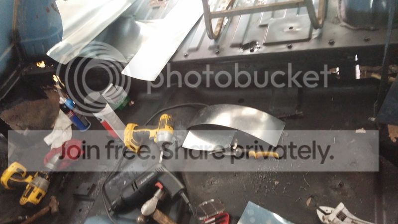

Passenger side is done

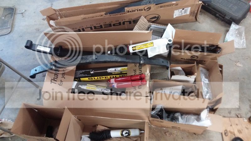

New parts
