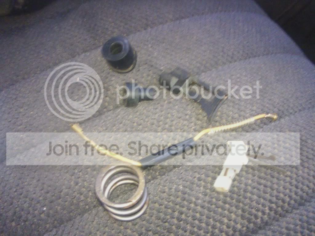

yea i knew the lever pops right out it is not the lever its the internal guts(turn signal switch) it does have cruise control and their is currently no turn signal switch in the column. the steering wheel is currently loose and floppy cause either the switch isnt in there or the little bearing that goes in the shaft is bad?
well i took it all apart and the previous owner had just cut the turn signal switch out of there as in he just cut the wires in the column that connect to the switch i dont see how the lever connects to the turn signal switch? if i dont figure this out im looking at taking it to a shop which i dont wanna do!! some one help me please!in the pic you can see all the wire connectors wich are on the wires that are supposed to go to the switch but were cut please help i dont see how the switch hooks up to the lever or anything
you need to hit a junk yard for a parts colume to scavange parts off of.
and the 88-94 trucks will not work for whole unit swap but the upper parts you need will swap to your older one.
and tilt is diffrent than non tilt.
yep thay do but still missing more unless you took off some.
like i said for you best to grab doner unit from junk yard truck and pull parts you need and see the order there in.
