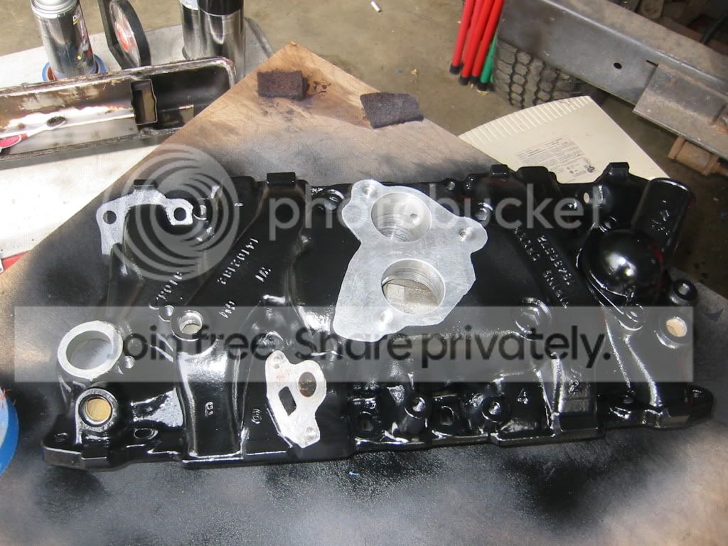

In the picture below of the manifold is the plug just to the top right of the TBI flange a plug for a vacuum port?
First, it's doubful that you'd be able to remove that plug, second, that's a large NPT thread and you'd have a VERY HARD time finding a fitting that would fit and then have a nipple small enough for the hose you want. You just need to find a fitting that fits the circled NPT thread that has however many hose nipples that you need. If you need 3 or more then Fords are a good source and they used a fitting with up to 5 or 6 hose nipples of various sizes.
