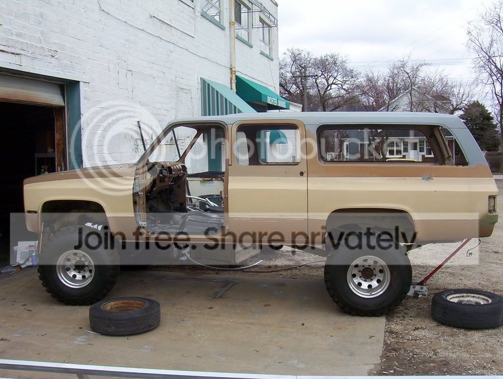

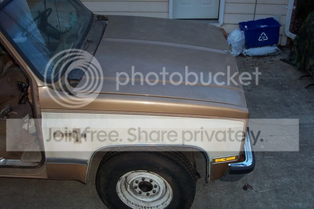

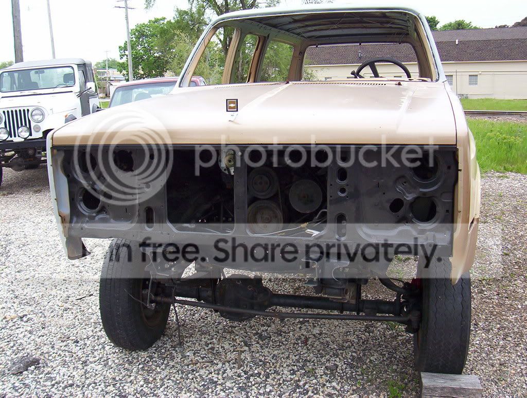

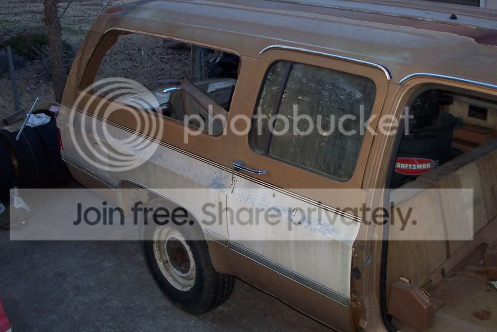

This is how it started
$500- Ebay Drove to southern Georga for it.
No Engine,trans,Interior,Glass,Front doors And 2 Wd.

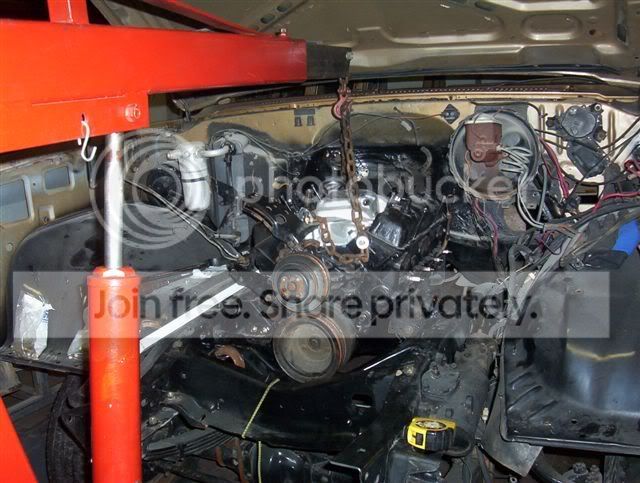

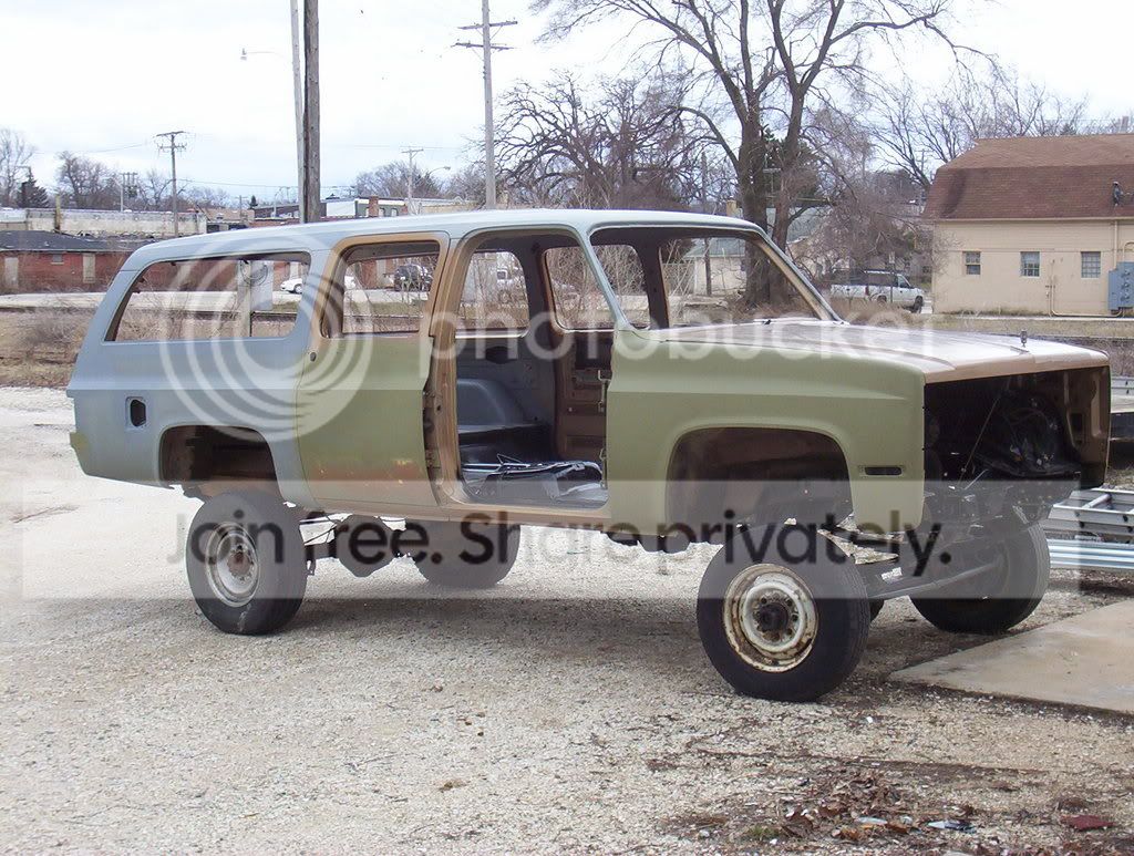

Now---

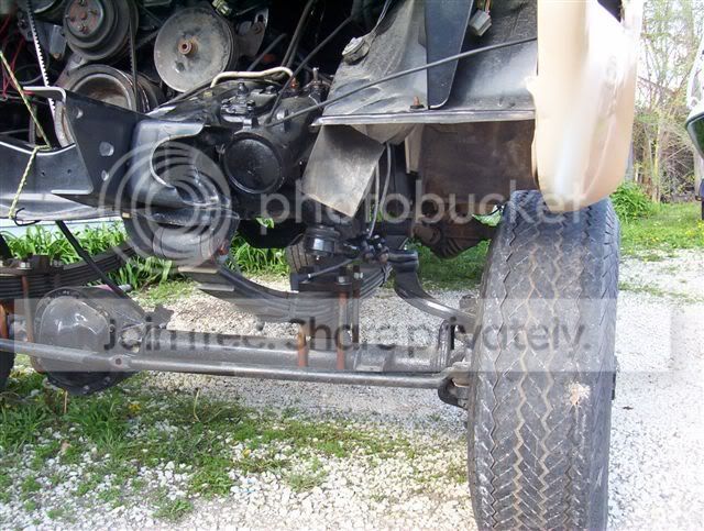

New 400 Hp 350,Th400, 208 for now And 4WD

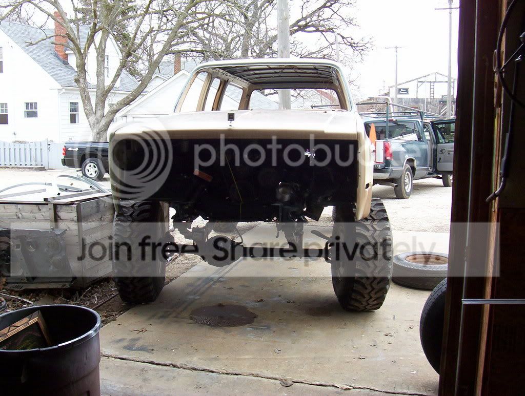

OOOOOOO------- 39.5 x 15 x 16.5 Ground Hawgs
Still lots to do
looks good, it's surprising how small those tires look against the sheer size of the burban. My 35s look stock on my suburban, can't even tell how big they are until a jeep pulls up :)

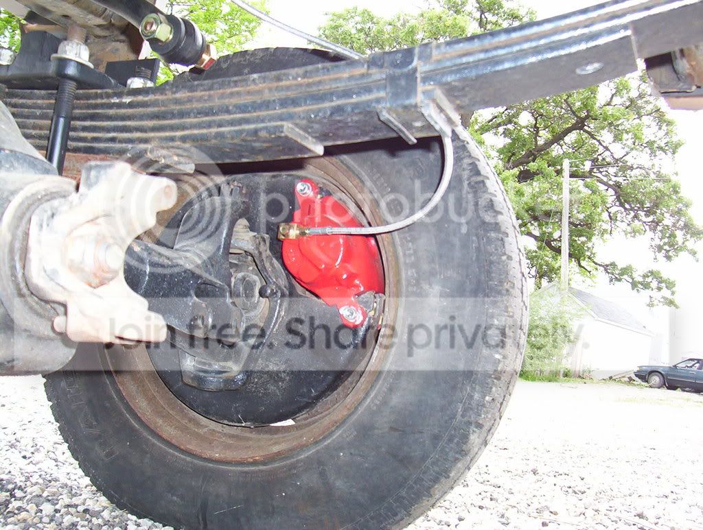

6" Springs up front
4" Blocks and Comp shackels in the rear
Lookin for used springs for the rear ( I hate Blocks)
4.11 Front and rear
Dana 44 Up front
I foung a DRW 60 for the front, So once the hubs are done, The 60 will go in.
Hawgs must run small b/c that looks perfect with 6" on 39.5's... I have 8" and my 38.5/16-15 Claws rub up front a little...
What did you do about your rear pinion angles and drive shaft length? Im looking for a way to fix mine..
