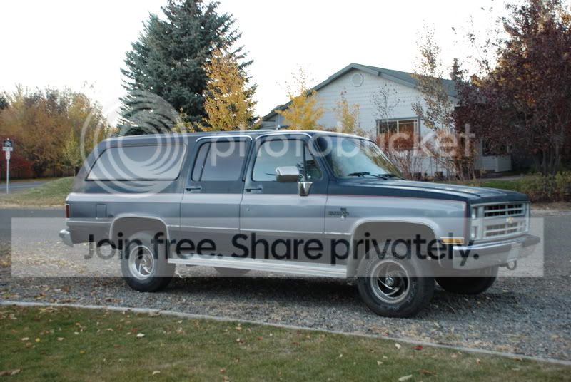

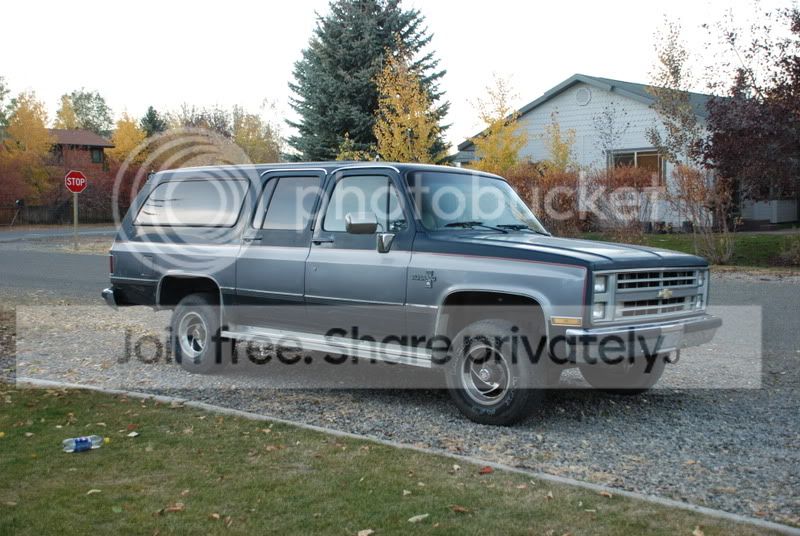

BEFORES: 10-NOV-08
The tires are coming from Colorado.
Better looking than my 'before' pics! :waytogo:

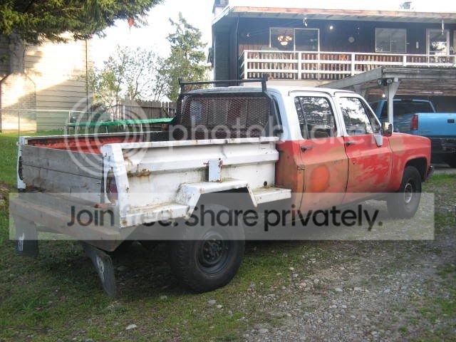

I bought the world's ugliest Crew Cab...
Rene
I intend to keep it as filthy as possible, but the day the paint starts to go, I jump out with my rattle can!
My dad wasn't to happy when I first sprung the news on him about my intentions, he wanted to keep it stock height with the cruise liner running boards. Out of the question...

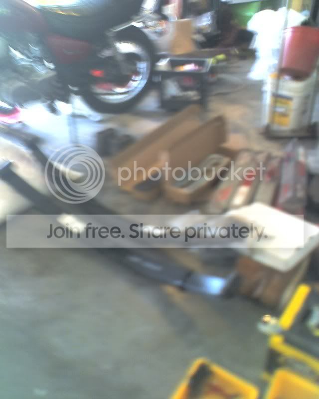

On a lighter note, I now have full access to a diesel shop for my lift. They have a hydraulic frame lifter.
Awesome...although it's almost too bad you won't get to break your 'lift kit cherry' doing it the hard way. It's almost a rite of passage. ;)
Should be a ton safer, easier, and quicker for you!!
Rene
Well, I kinda regret not choosing to do it in the driveway, or in a level parking lot, but they have the tools, the lifts, everything I need. When I can get my dream garage of full snap on tools, 4 floor jacks, and all the 10w30 I could ever dream of at my finger tips, that day I will lift my truck. Until then, still a high school drop out, and still reading over these install instructions online.
