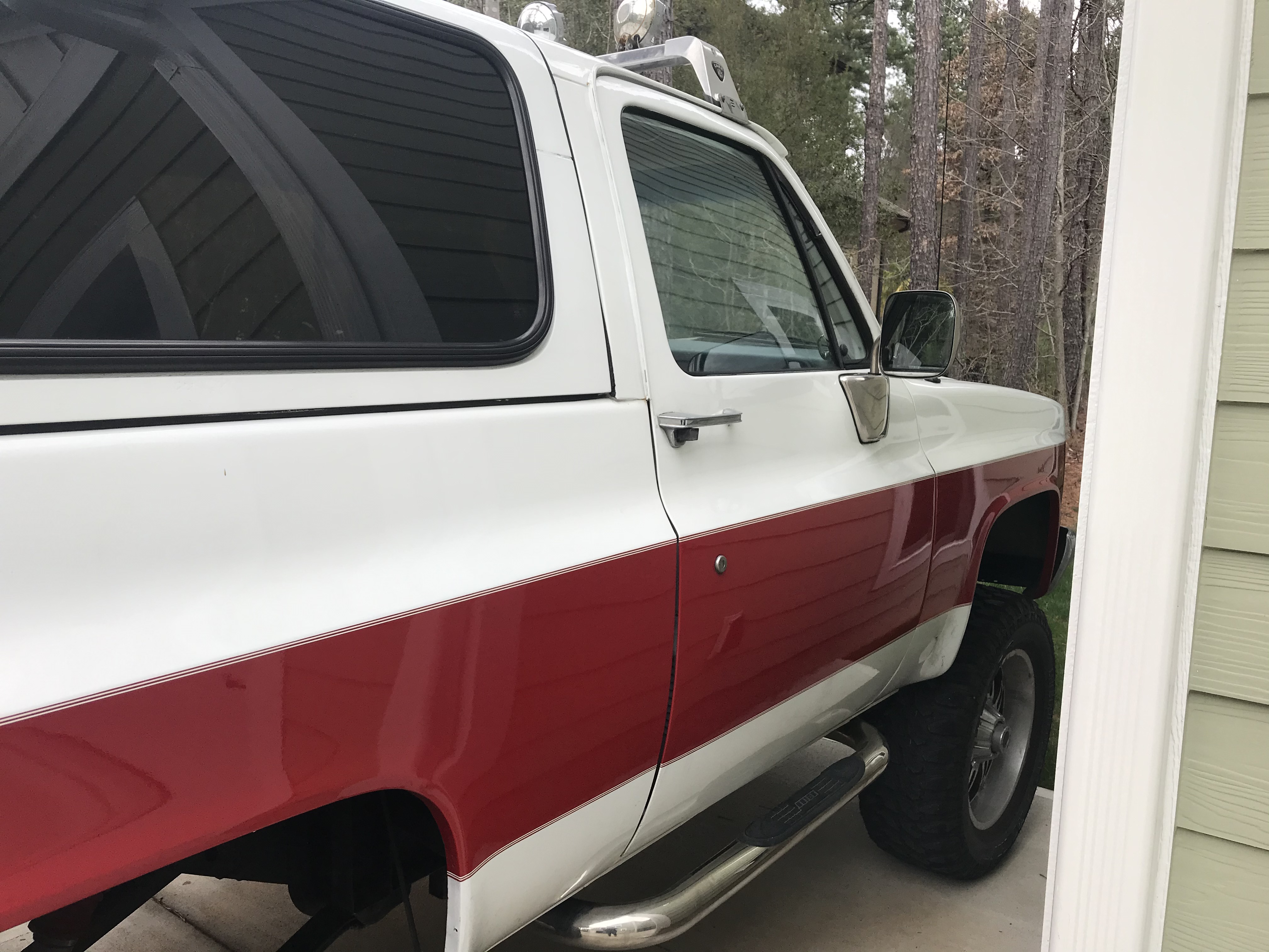

When the truck arrived I first noticed not one window worked, the dash was literally an overlay that was painted on, the wheels and tires were no name and just a little cheesy for my taste (was going to take these off and sell anyway), temp gauge did not work and AC was not working. Engine did run well with no leaks at all. Has a rebuilt 350 with 700R4 behind it. The engine bay is a mess and on the list (possibly crate motor in future). The front end was a disaster and faded and the entire truck needed to be wire wheeled. So much more was wrong which I’ll cover as I go. The bottom line is I I have fallen in love with the truck even with some of the problems she came with.
A few picks of what I started with, I’ll try and add to the thread daily.

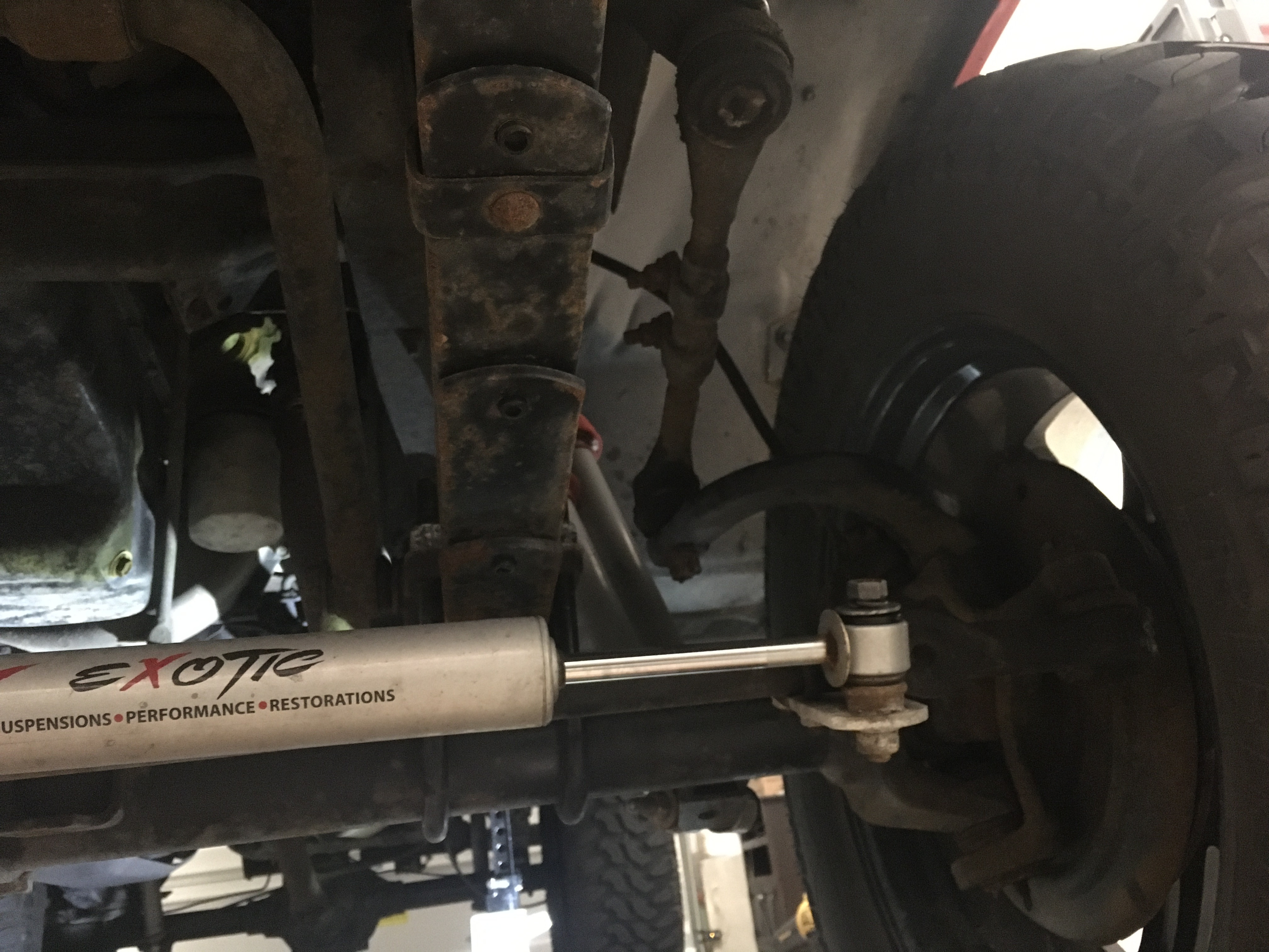

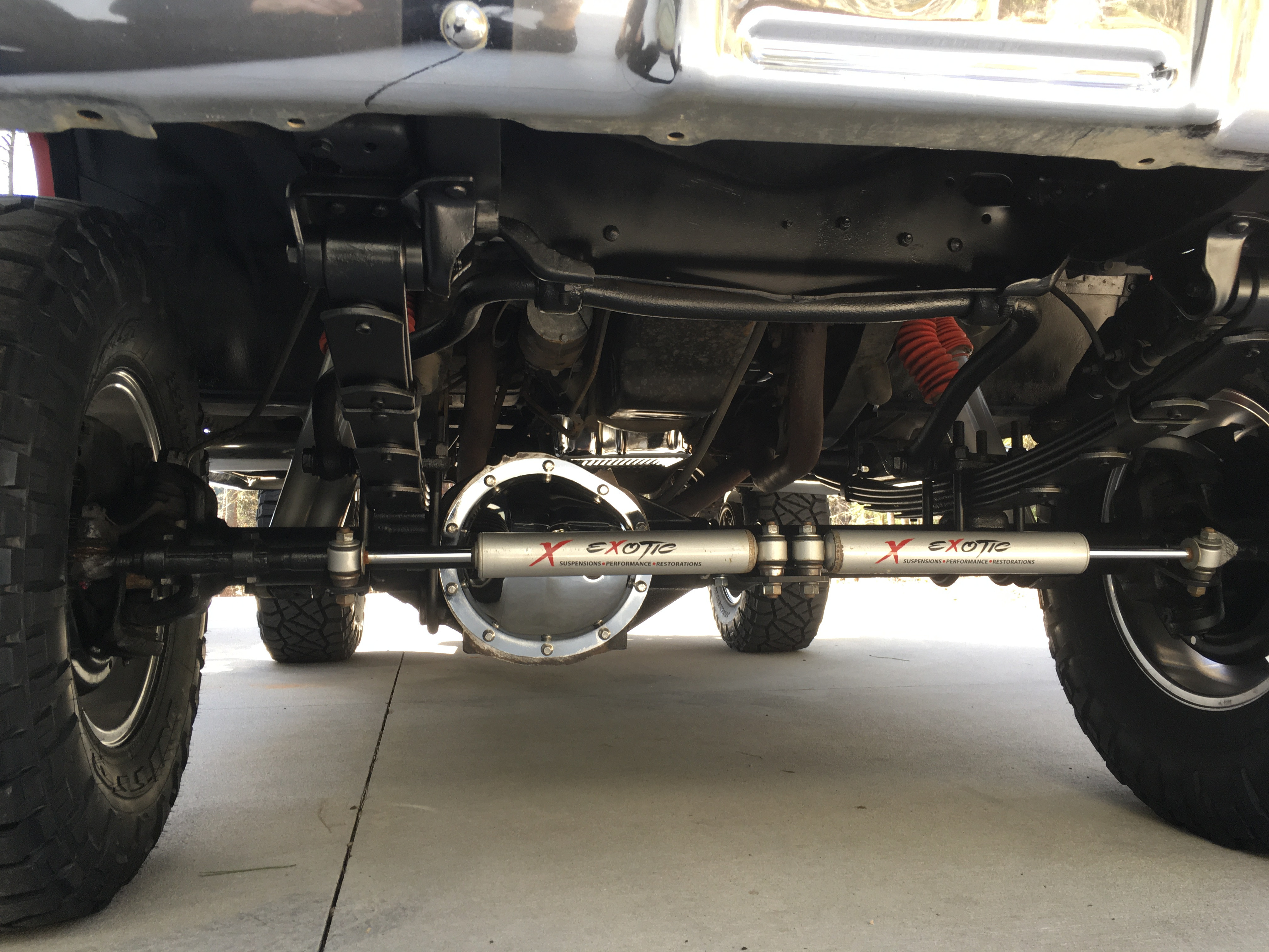

So the first thing was a clean up of the front axle and surrounding steering components. Wire wheel everything and then 2K primer and 2K paint. Added chrome diff cover to the front axle. Cleaned and painted steering stabilizer brackets and all around clean of bolts. Before and after pics.

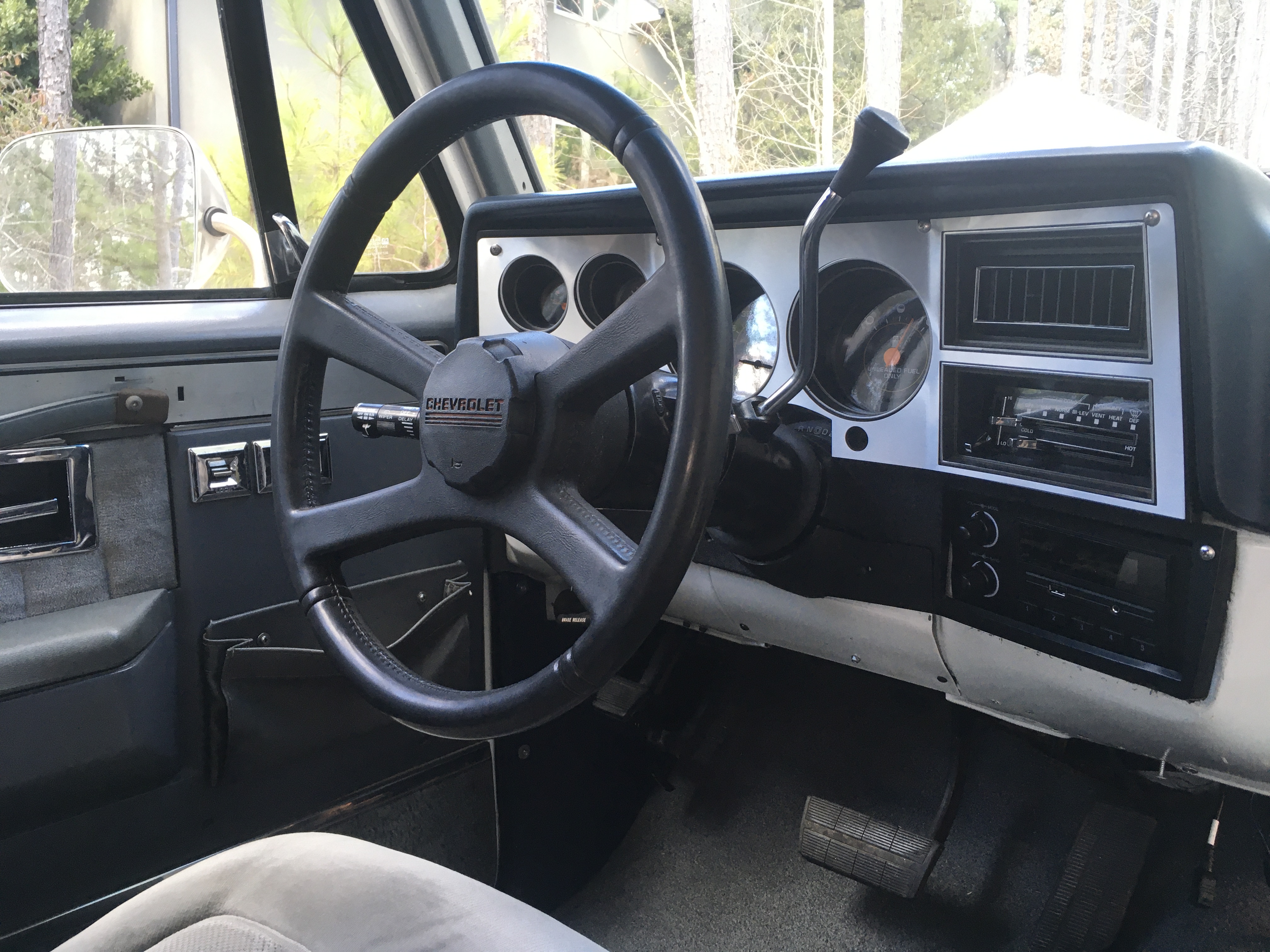

Next was the dash I talked about earlier. The old dash had a pad glued on and was just sitting in the truck. Removed and put a new dash in with bright work. Replaced speakers and cleaned up rusty brackets. Put in. Retrosound stereo, more to follow on the stereo system later. Replaced the clear gauge cover and replaced the temp gauge. Also painted the white overlay on the dash. And a good clean.

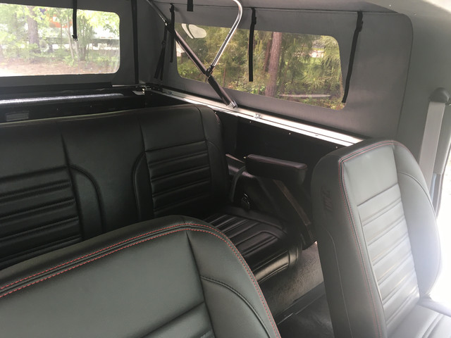

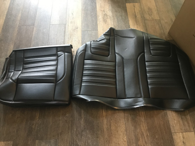

Upholstery is next, TMI Front seats replaced the stock K5 seats. Ordered the matching bench upholstery for the rear and recovered the rear myself. Not a very fun project but turned out fantastic. I actually put the covers on over the factory covers which gave it the right amount of tension since they were worn.
