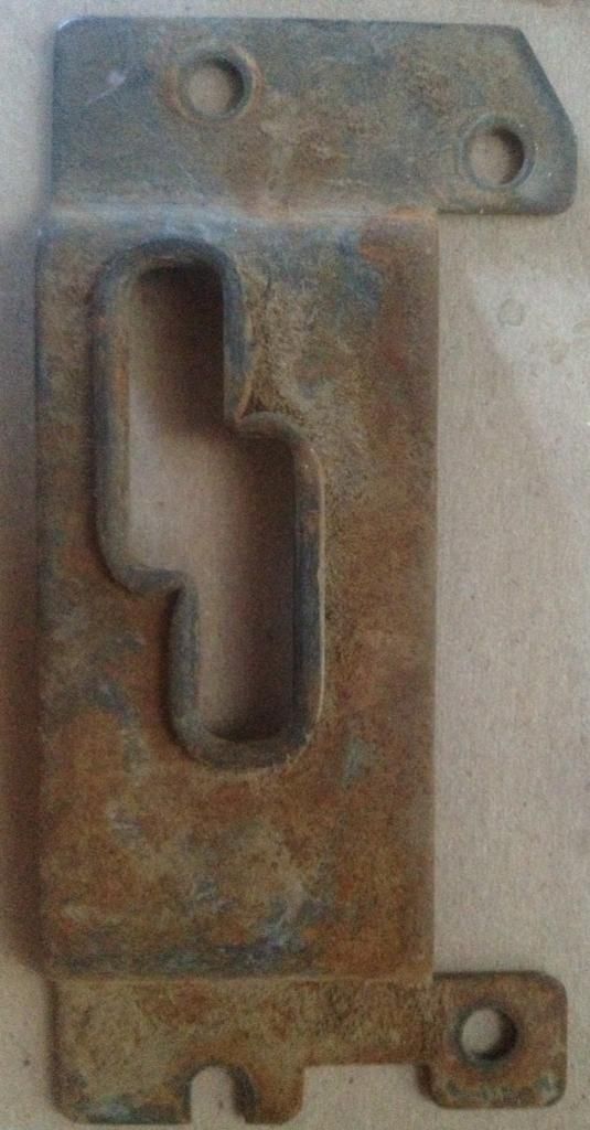

Hmmm. You need to pull off your plastic bezel. I happen to have my shifter out while bedlining my interior (and rebuilding my 208). The Z-gate, the part that makes you push it to the right, is part of a metal bracket that mounts to the shifter assembly, but under your plastic trim bezel. You should NOT be able to pull straight through with this in place. At least this is all true for the stock 208 parts on my '88. Pic below.
If the z gate bracket is supposed to be on the NP241 then if my memory services me I think that bracket is missing.....
