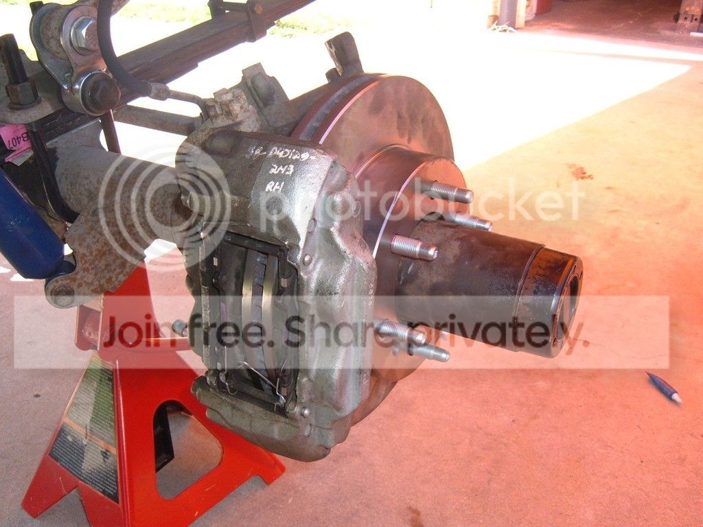

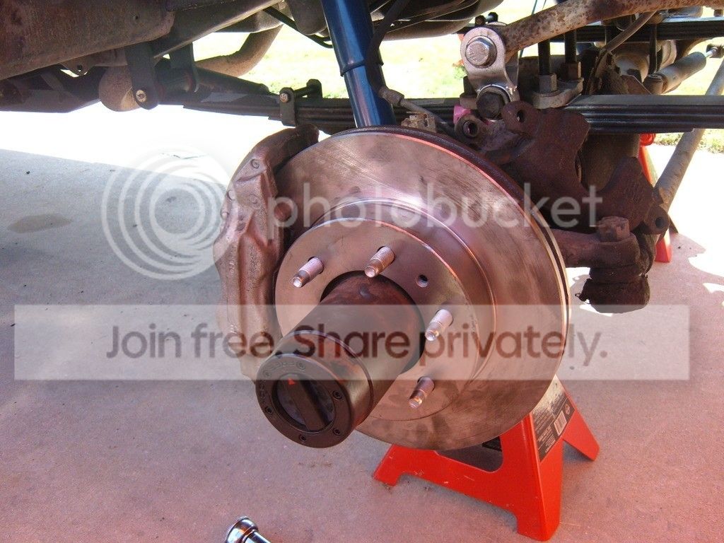

My brake upgrade thread.............................
https://ck5.com/forums/threads/pure-chevy-sex.316597/
With the front 4 piston/larger rotors and the wider disk brake rear axle, my suburban stops like a brand new truck. Plus the parking brake still functions.
As noted in the build the drill size I used was a little big, I would have definitely preferred to find a smaller one to get it perfect. But I haven't had any issues yet.
