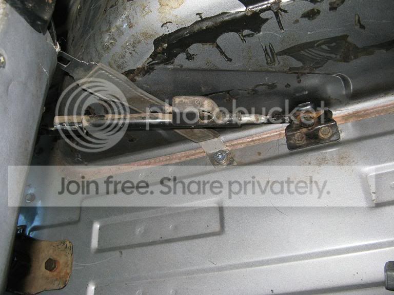

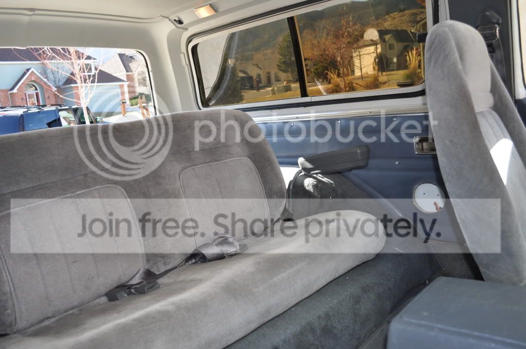

Here is a pic of Teck's rear that looks like my 89'....

Jeff, is that the factory setup in you '89? My '91 only has a center lap belt and receivers for the passenger and drivers side mounted to the seat. The belts retract into the top and bolt fast to the floor in approximately the same location as what you have pictured.
Yea, that's what my 89' looks like. The bare metal shot is someone elses rig but looks just like mine as well. On the bench seat pic, the left most buckle extends and retracts. The far right side does the same. The center is a typical lap belt set-up.
I just don't know what's under the 90 and 91 truck floors. I would almost guess those nut holes are there.....:dunno:
I'd be willing to bet they used the same bolt hole, but just switched to a different style belt. The question is can we get a retractable belt that would mount in that location and work with what we already have on our seats?
