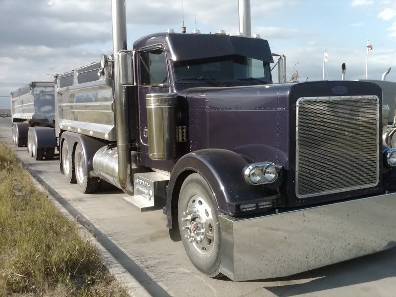

this guy is running licensed 121,000lbs with a swapping in 14L series 60 EGR disabled, much more hot rodding dynoed 1400hp. but he's doing pistons every couple years or less.
