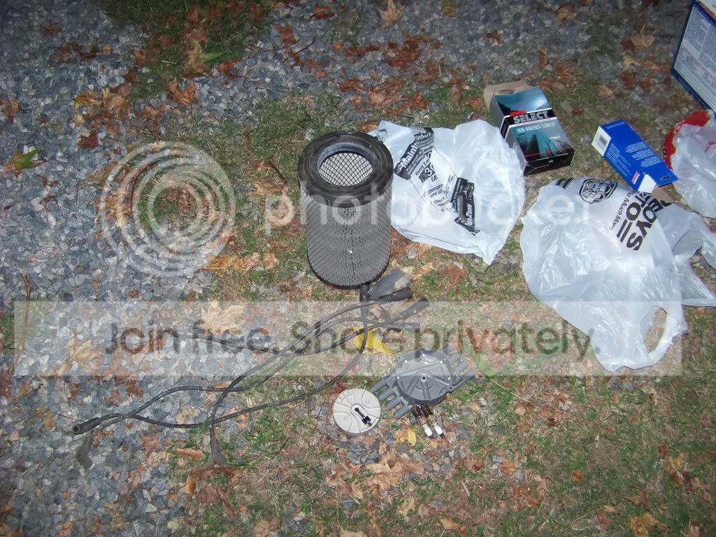

ight so i got plugs,wires,cap,rotor,air filter and a fuel filter for the amazing low price of 130 bucks :screwy: holy crap i forgot this newer stuff is more expensive to work on..going to start putting it all on in a few

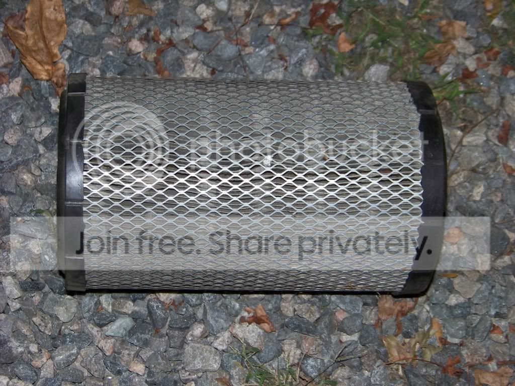

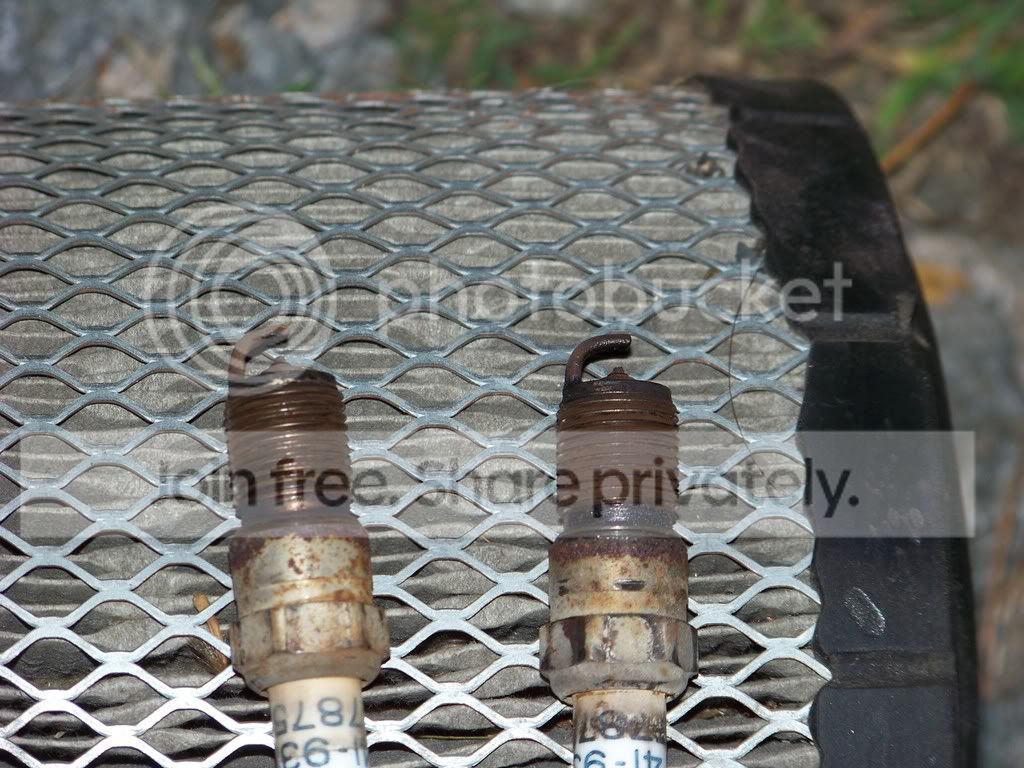

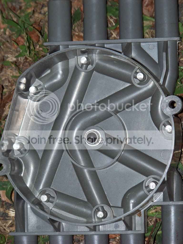

did a tune up...it needed it badly...i dont think in 160k it had ever been done...definite diffrence in power...we tried to clear the light the old fassion way (unpluging the battery and touching the cables together,no airbag dont worry) but it didnt work...hopefully i will see a diffrence in gas milage now
some pics i took
i should have taken a pic beside the new filter total diffrence
the plugs were bad
the cap was corroded too
