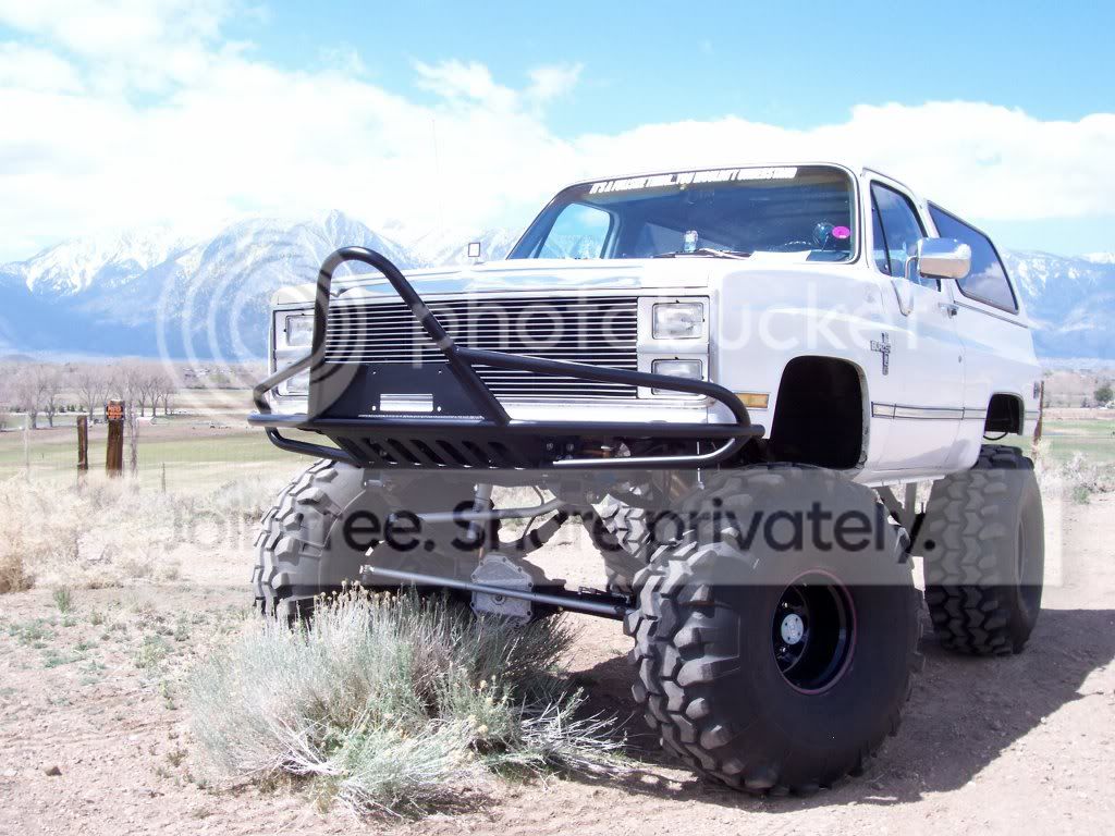

Here's mine, 2.5" Superlift 52's (with the overloads removed) on the front with 7.25 shackles. The tires are 42" TSL's.
As you can see, the shackle angle on mine is not that good. When I moved my shackle I pivoted it forward on the lower front bolt (I think I got the idea from one of the original 52" swaps). This works well on stock springs but my lifted springs are slightly shorter from eye to eye (presumably due to the increased arch). Anyway, if I had it to do again I would move the shackle further forward and use a longer shackle.
I think your shackle angle looks pretty good. It's past vertical so it already on the compression travel so it will work good. Nice part is, you'll have a good amount of shackle travel before the spring flattens out.
That's where i like mine.

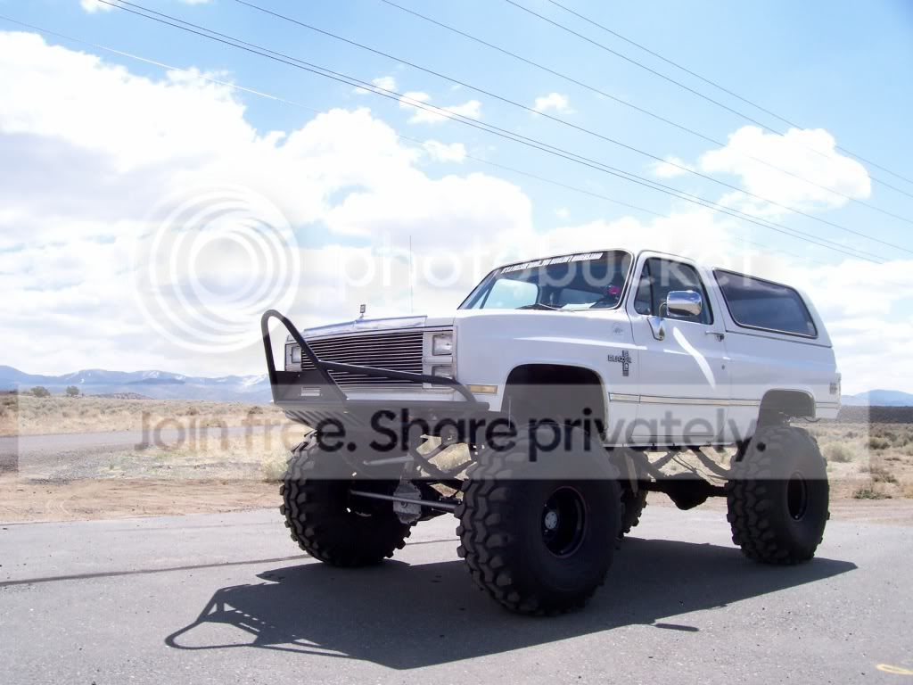

As mtblazer said, i am running 8" lift tc springs up front.. and i still rub 44's pretty bad without cutting. I dont have a front dshaft yet so no hardcore flex shots but from what i do have you can see how the flex. As for actual numbers i think mine actually came out round 10" lift, and i based that of the numbers from my rear suspension. I'm running 4" lift 56's out back with the diy4x shackle flip and 6" shackles along with a 1.5" zero rate... and my front needed a zero rate up front to even things out a bit. Anyways on to the poser shots
God damn, that's a huge bitch! :eek1:
Nice though, glad to see that you did it right. ;)
