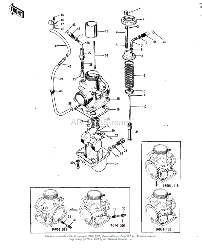

This might make it easier, when I refer to a number it's on this picture. My 30 in the bottom of the picture is the 16014-011
I've been riding the bike around the yard and it started fouling out the plug. When I adjusted the idle the first time I was a retard and just adjusted the cable at the handle before it splits off to the carb and oil pump. That was keeping the throttle open and the oil pump pumping too much oil in. Now I have it adjusted so 13 is closed and the oil pump is lined up with the marks on it. I checked 30 (pilot adjustment screw) and it was turned almost all the way in, so I turned it out 1 1/4 turn. Now when after I kick it till my leg is tired it'll just pop and occasionally run for about 5-10 seconds and then act like it's out of fuel and die. Oh and I have 12 (jet needle) in the middle position. I've tried adjusting that and it acts the same.

Ok, so last night I tore the carb back down and boiled the carb and all the jets. Today I reassembled everything and put it back on, I also threw a hotter plug in it (a B6HS and it takes a B10HS), I don't plan to run the hot plug forever, just long enough to burn all the old oil out and if there's a chance of there being any old oil in the intake. It'll run now, but the throttle valve has to be atleast an 1/8th of the way open, it won't run with it closed. I tried to adjust the throttle stop like the book says and it didn't do anything, no change at all if I turn it all the way in or back it all the way out. (The book says the throttle stop is what adjusts the idle).

Oh,and in the picture I posted before what is #30 in 16014-006 on the bottom? I have a jet there like the main jet, not one like that with a spring behind it...
