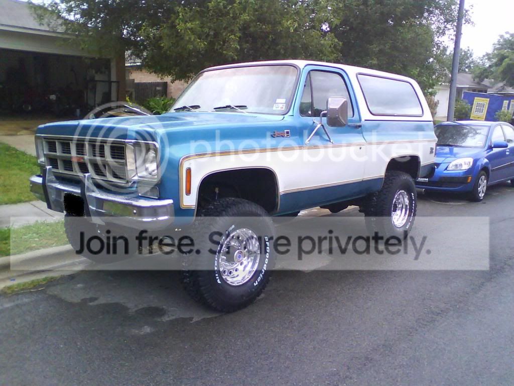

2 weeks and 5k later.
77_Jimmy
Oct 16, 2008
522
136
Justin TX
soo details?
you bought it for 5k and it took 2 weeks?
you bought it stock and added said items costing a total of 5k and took 2 weeks?
you hand built it in 2 weeks and cost of materials was 5k?
;):haha:
I see new axles, new tires, new wheels and a lift...
Are those drive flanges??? Maybe lockers and gears???
Nice rig...
Yea , rebuilt d60/14bff 4:10 gears open in front with a spool in the rear. 4 inch Skyjacker all spring lift. Longfield drive flanges. 315 75 16 tires on 16x8 Raceline Rockcrushers. Only notice the spool if I'm turning out of my driveway or turning from stop sign. Running drive flanges cause truck still has fulltime 203 . And 35 spline outers on the d60. Spent 2 weeks in the garage doing the change over.

I will post some poser pics Sunday night . The pic I posted was in the rain with my cell seconds after removing the jack. I'll wheel it some , it will never see rocks. Just a overbuilt camping , atv hauler truck.
