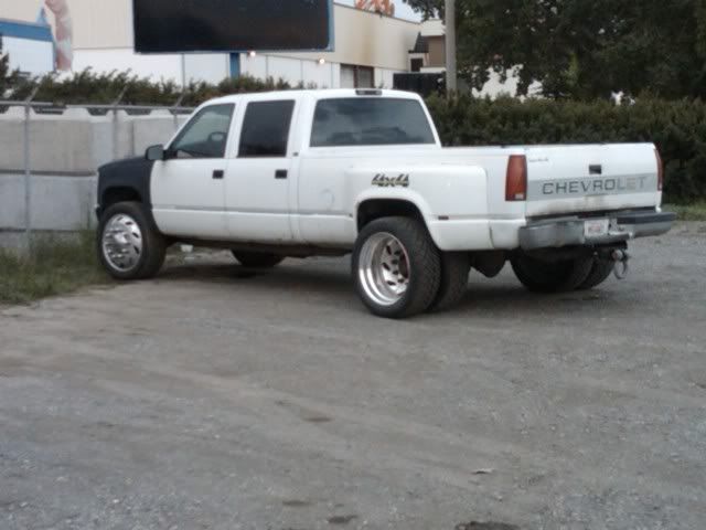

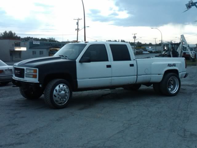

Im not sure why guys think all bigger rim tires are way out there.
case point- although slightly different application
I paid $1500 canadian dollars for 6 305/45r22 Nittos.
they do fine.
