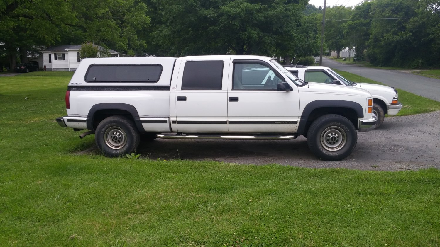

So I abandoned the rack idea and just went with the camper shell. It made the trip to the beach this year so nice. All our gear locked up and safe from the weather so we didn't have to worry while traveling.
Also before the trip I replaced all the for lock motors, the front door handles, passenger side door hinge pin bushings and the front speakers. Also bought a set of Iron Cross Automotive Stainless Steel wheel to wheel step tubes for it. It turned out that they are wheel to wheel length for extended can only, not crew but they fit and work well and are stainless so I stuck with them.
I'm considering a zero rate for the rear to level it back up after having to add a little more lift to the front to stop some scrubbing, but nothing doing soon. Anyways, here's how she sits now!

Truck looks good still! I'm still debating on running fender flares. This gives me a good idea of what it would look like.
That's about 1.5" bar crank in the front on 285/75/16's. The 4wd trucks came with flares and I stuck with them even though they don't quite fit right in the rear. I'm probably the only person who knows they don't and I'd say a solid 98% of people who see the truck don't realize what it is.
