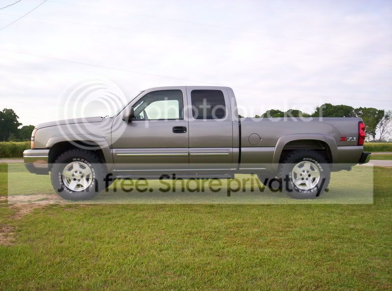

i want to lift my z71 a bit and cheap as i can. i already cranked the torsion bar all the way up, good quality shocks, etc, and the rear is new good quality shocks with coil over it. sits pretty level.. i want to go a bit higher, i was thinkin abt 2500 hd rear springs on this with same half ton block already on. and the front, change the keys .. wonder if this is good?? http://cgi.ebay.com/ebaymotors/ws/eBayISAPI.dll?ViewItem&ih=015&sspagename=STRK%3AMEWA%3AIT&viewitem=&item=250078961680&rd=1
or get a ford keys?? any of u guys got any other tricks to lift the truck? im tryin to stay away from body lift. i would do a 1 inch body lift myself.. just tryin to stay away from them and see what u guys have in mind.
reason i want to know is im getting a 285 75 16 from general grabber at2. so i want to get my truck another inch to 2 higher. let me know what u guys have in mind. thanks... this is my truck with 265 75 16 on them now..

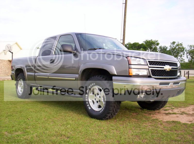

you dont even need to touch the t-bars to fit 285s
my buddy is running 305/70/R17s (34"s) on his 06 with no crank and no trimming...
damn.. nice truck...:thinking: so i should be good with 285s.. i think my plan is 1 inch body lift. and crank down the torsion bar a lil bit.. maybe it'll ride smoother...
