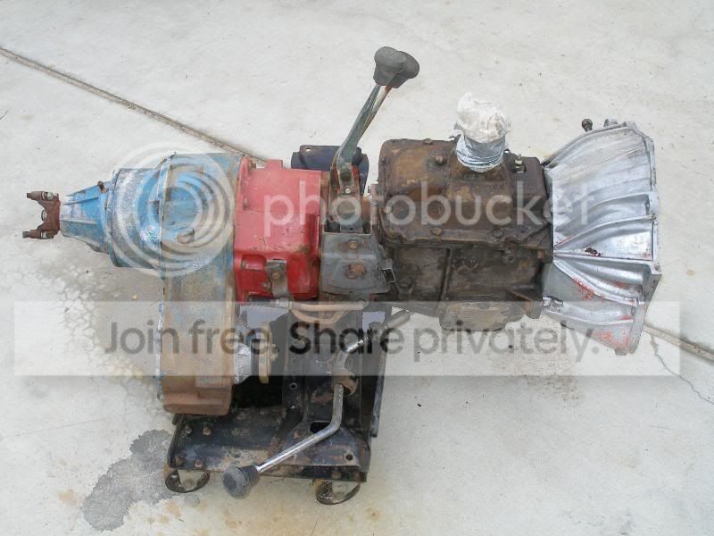

I'm certain this has been hashed many a time but I can't find it anywhere. Well, with good pics/details anyways.
What I am asking of you all is that if anyone has GOOD pictures or drawings/plans for a twin-stick for a 203 or knows a link with what i want, please post them or contact me through this forum. I really would like to get a twin-stick for my Blazer. I hear the 203's original shifter is crap and well that seems to be my issue. I know of the ORD twins and I don't really wanna be paying much for the parts. I just want a SUPER cheap shifter idea. Please and thank you all.
If you get 2 shifter setups for a 203, you can take the main levers out of both, and make one unit that has 2 handles coming out of it, then use the stock linkage. You will have to drill out a rivit, and replace it with a bolt instead.
thanks oneton...you wouldn't happen to have shots of it during construction...i am sure its dead simple i just don't wanna have to tear it apart a bunch of times to get it right....
I don't have any pics, that is the way I bought it. Looks really basic though, with 2 levers that pivit off a bolt in the middle.
Ok, Just to finish up the thread. Here are some pics.
The image labels indicate the shifter locations for each gear. Hope this helps people out in the future.
