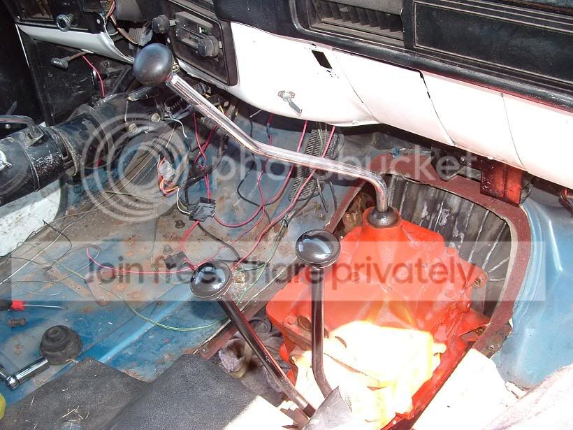

mine is a home fabbed set. I ground the rails myself(easy) and found an amigo twin boot for free :D

I just did a homebrew for about $15 in random parts and some scrap steel. Used two stock style shifters, had to bend one slightly. The old setup got donated to donimator's rig, I'll be redesigning for my triple shifters and starting from scratch rather than using stock shifters. Already got the ideas brewing in my head.

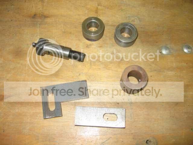

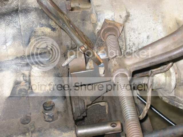

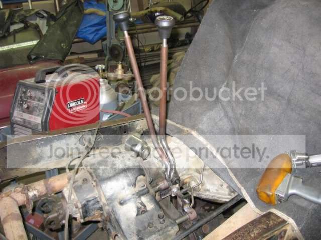

I built my own twinstick with 3/8" shift rods...
I used the old bolt, welded the factory grease grooves, then machined a groove for each shifter. The other backets were made from 1/4" and 5/16" CR steel. After everything was machined, I clamped the brackets in place, then welded them. (Using the case as a jig)
