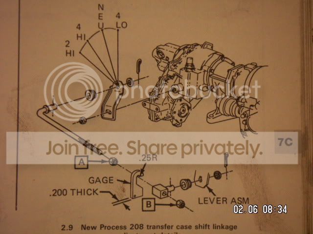

Beast. Define 2" towards the Tcase. Do you mean shortening the linkage or lengthening it? I have a 6" lift on my 91 and have had it pop out of 4hi and 4lo.
Here you go:
In the diagram, that blue85 posted.....
-The simple explanation is to place shifter in 4Hi.
-Then, get under the truck, and loosen nut "B", first.
-Then, loosen nut "A", and keep crankin' it toward the t-case. (mine took 2")
-move the "lever assembly" (square part), flush with nut "A".
-Tighten nut "B", to firmly hold 'lever assembly' in place.
- take the truck out and test it.
It took me two adjustments to get it right... :D
My shifter now *clicks* into 4hi, and 4lo.
You can tell the difference after proper adjustment.
Fwiw... the directions, especially step 10 (wtf?), didn't make any sense to me.....
Maybe 4x4 high, or someone, could shed some light on the gauge tool, as well....
I didn't use one, but I don't use gaskets on my diffs either.... :whistle:
I've never heard of anybody using that shim tool. Just put a screwdriver in there or cut a thick washer. Having the adjustment right not only prevents the case from "popping out" it also maximizes the life of your shift pads. The fork can "float" out of the way if the linkage allows it. But if the shifter is against a stop it forces constant rubbing on the side of the pads.
