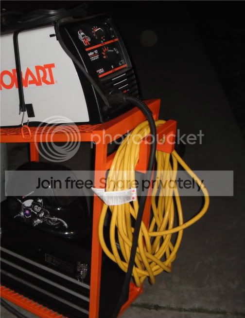

I copied a "welding: how to" site, for my welder ext/adaptor.
http://collierwelding.com/tech/weldercord/
I have a Lincoln 180HD. (230v)
Is this correct?
I don't want to start a fire, or kill my welder, or myself. :thumb:
I could be HORRIBLY wrong.... That's why I'm asking first.
Is your welder 220 volts? Because your drier probably is and if the welder isn't you will burn it up.
Ok if the diagram for the welder is a 110 receptacle the diagram for the dryer is a 220 receptacle, but either way it is very very wrong. What voltage is your welder?
Ok on a 220 volt receptacle there are two hot wires and a ground. The L shape is the ground and the other two wires are both hot. On a 110 receptacle the ground is the round hole, the smaller of the two spades is neutral, and the larger spade is hot.
No its 100% correct, he just used different color wires. Just make sure the receptacle is rated for the voltage and amperage you require. Sorry if I would have read a little closer I would have realized you were making an extension.
Oh... I see yer confusion. :thumb:
Cool.... No house fires. :D
Both plugs are rated @ 50A, 250V.
The wire is some SUPER BEEF wire I got from my welder buddy... For FREE. :thumb:
All said, I'm in my 12', 230/220 adaptor/ext., to the tune of ~$21.00 :woot:
Don't look too bad, either. :dunno:
EDIT: for amperage stupidity.... :doah:
