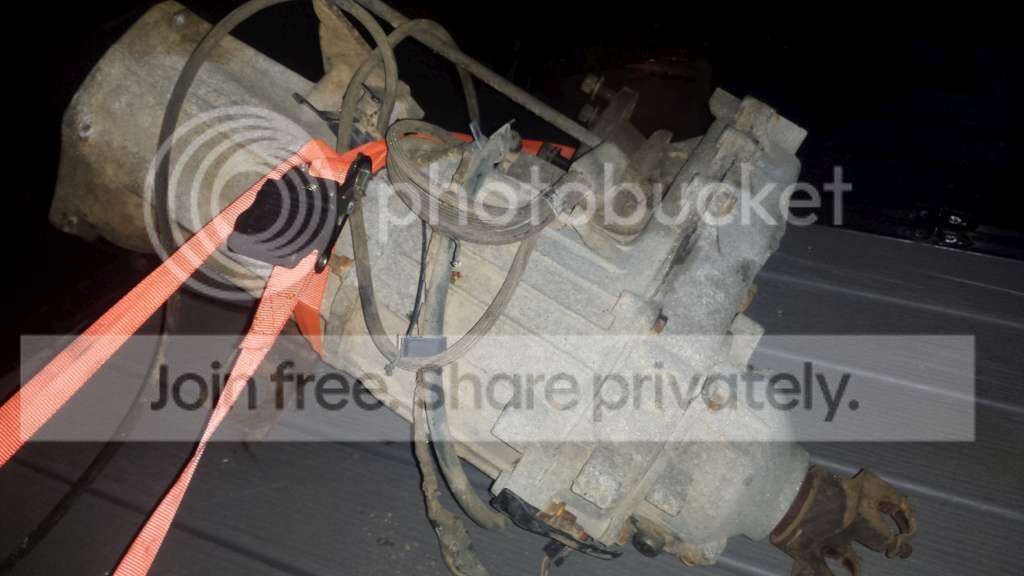

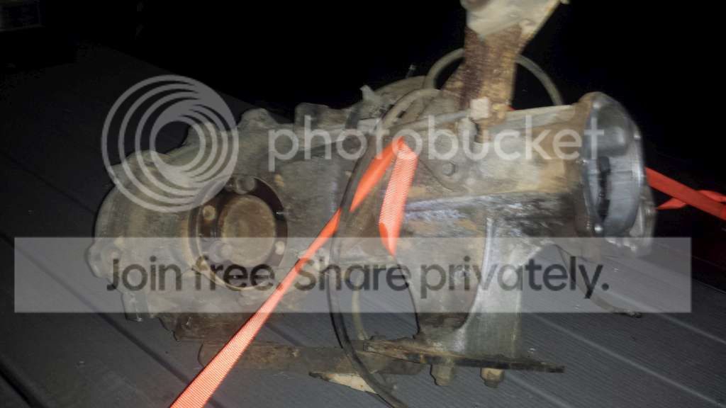

I picked up the rear case tonight.
Look at the freakin adapter! With a mile long adapter like that its no wonder dodge needed the fixed rear yoke... I also threw the guy $20 and hes gonna cut the output shaft off the trans and mail it to me since the trans is toast anyway :waytogo: Save me a huge pain in the ass. And I guess Im gonna turn this thread into a 241/241 build thread...
