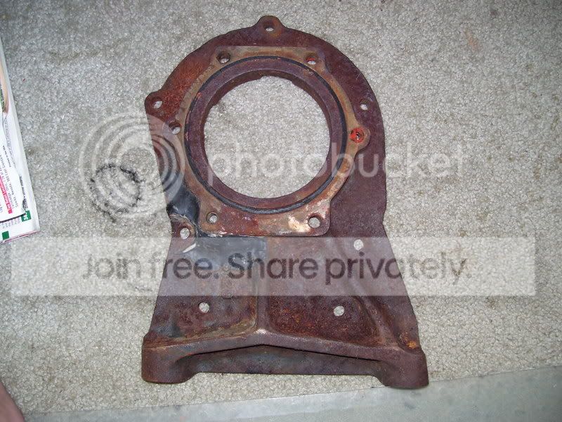

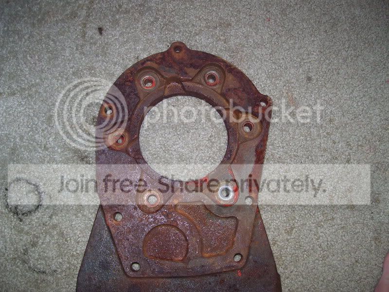

the part that mounts to the tranny has 6 bolts in a pattern just like a tire/hub.
the other part has 6bolts as well and looks like the one that i just pulled off a 203/th350.
here are pictures HELP!
haha and this is for an auto tranny correct? the one on my 465/205 is ALOT longer/wider (whatever you say) than this one...
tha adapter on your 465/205 is out of a newer rig isn't it? Have a 32 spline output shaft on your trans?
Pretty certain that is a 465-205 adapter, 10 spline. What the majority of them were. The shortest 4x4 combo that came factory.

i know its not for the th350, ive got one for that application and it aint the same....
so its for a 400? mkay...
