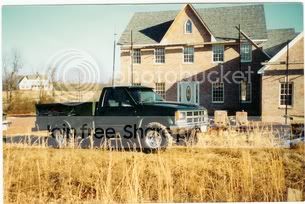

    I get around 15 im a 8,000# truck with 285/75s,4.10s,and NV4500.Lee Swanger had a custom built N/A 6.2 bumped to 6.5 with other mods,mostly a huge filter housing w/dual cold air intakes,matched ports,and his own enlarged exhaust manifold couplers,that produces 200hp.His favorite saying is,"Don`t need no steenkin`turbo."
    In`99 the mark to hit was 300hp and this is pre-Dmax.I like dropping Newbie diesel owners (most of them are) with my black smoke cloud in my low-tech soap-burner.I`ve got full arp hardware and lined water ports in my heads.The block is the post GM high-nickle/beefed main web GEP block.The Diesel Depot has a cam out.I think Lee Swanger runsone.They built his motor.For years the word was deck clearance was too tight for higher lift.Maybe with the low compression pistons play the match-maker in this.
    Here`s another cool site: www.marinediesel.nu
    This is the diesel work truck:
