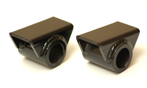

Edit: or would something like this work?
Are you asking if you can have shackles at both ends of the spring? If that's what you're asking, no.
If you get the t-case crossmembers from a 4WD truck you can drill holes to make them work.

if you mount it up like this you will need to box a good section of the frame rail. the o.e. design mounts the bracket to the upright section of the frame railto hold the load. if you mount up what you want with out boxing the frame rails in that area. you will fold up the frame rails and bend stuff all up.
then you will need to lower the front mounts to match the drop you just installed over stock specs. as the springs will sit to low in the back and mess up all the caster/camber built in to the axle.
so sort term save money and time no. but if done right yes it can be done.
So maybe I'm better off just making a custom bracket that goes in the stock location.
