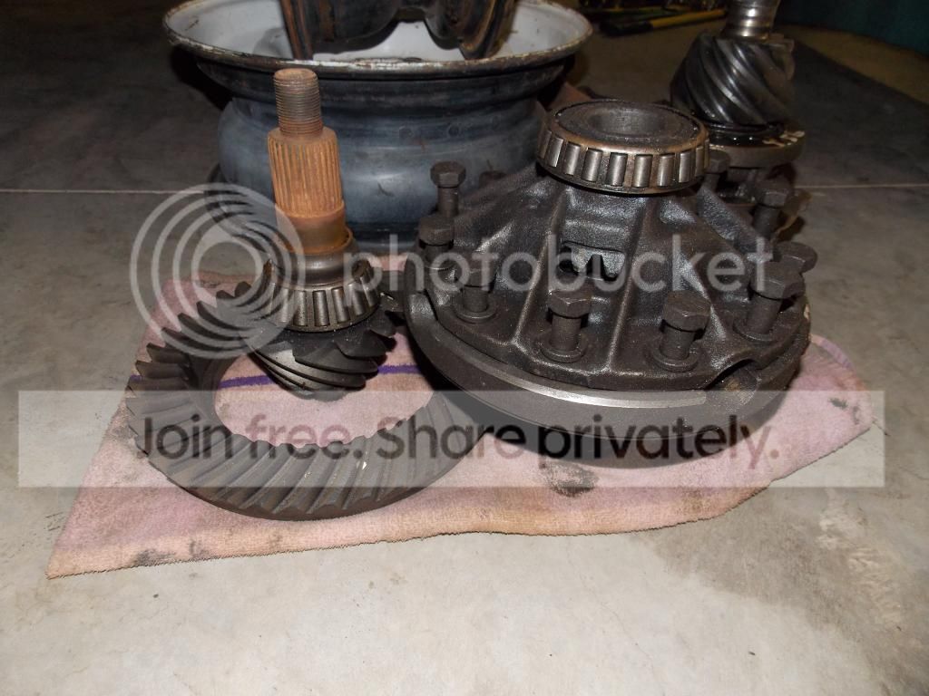

14FF 3.73 R&P were removed from a different carrier, both in good condition, $60 shipped to your door.
14FF carrier with spiders, thick case, fits the 4.56 thin gears, $75 shipped to your door.
I think I know the answer to this. But...would the 3.73's fit in an axle that currently has 4.10's? I'm not up to speed on carrier splits for the 14bff.
IIRC 4.56 was the split, so you should be ok... Im not 100% though
Yep, they'll fit.
4.56 carriers are a stand alone item. They use thin gears where the 4.10 and higher gears use thicker gears.
