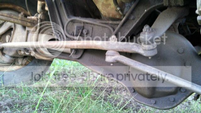

I think this would have 60 under the front, no?
http://eastoregon.craigslist.org/cto/3905911745.html
The truck is an '80+ body style which doesn't match the ad that states '78. My bet is, if the pic is correct, that's a TTB truck.
Looks like leaf spring hangers under the bumper in the second pic, no?
They did TTB with leafs also, Adam. Im going to eastern oregen next weekend but thats about 2hrs further than i planned on going... Otherwise i would be inclined to haul a trailer with me up there and pick that bad boy up! It would pay for my trip when i parted it out!
The real trick with the body style pictured is the F350's did NOT get D60's between '80-'86. Need someone familiar with Fords to try and identify the year based on the grille and body side mouldings.
He says he has someone looking at it tomorrow and if they dont take it, he'll get me the pics.
I think it was actually a mid 85 change. My buddies Dad 350 is an 86 and it has a 60 in it.
It seems Ford kind of did some mid year type stuff with the 60 going away from the TTB
