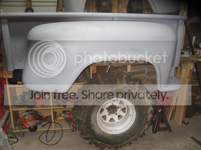

have you considered just lengthening the ones you've got? i had a set of v-bar style chains for my 35's, then when I switched to 38's I went to the local auto parts store and picked up some chain-repair components and added those to my existing ones. works great!

I am looking to get some chains for my suburban (on 35's) once it gets running. I will most likely have the local Les Schwab make them for me. My friends who drive truck and work in the woods have schwab make them chains for the heavy equipment and big trucks.

mikey: you can buy v-bar chains through les schwab - it's where i got mine originally meant for 35" tires. probably cheaper in a pre-made form than in a custom jobber...
