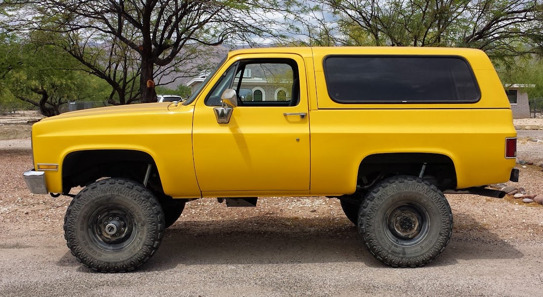

I'm tortured over the decision of keeping 35's or going to 37's. I want to keep the truck streetable and not too extreme, but I want it to look good and have good off road capability too. I think it's sitting at about 5" of lift and will require trimming for 37's. It's on one tons, so can handle 37's, and will flex a bit with ORD springs. Off-road driving will be medium-ish rock trails. Trimming is a pain since the body is good and I'm no good at body work. I'll need to hire it out somehow.
The pic shows skinny 35's. I will replace them no matter what choice I make.

Decided to go with 35's. Not totally sure it's the right choice, but it was a lot of trouble in terms of body work (to me) in order to gain 1" clearance. Anyway, here it is with brand new Toyo MT's. I'm still hoping the ORD springs settle in just a bit more. I've only got about 50 miles on them.
And here's the army truck, happy to have the skinny 35's back.

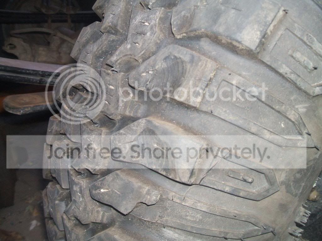

Truck looks good, but I hate to break it to you, you will need to trim the front fenders before you take that thing on any trails that will twist up your suspension. I chopped up two of my 35s back when I was on 1/2 ton axles and 4" tuff country ez ride springs with no trimming.
I twisted it up a little and it's very close. I'm aware I may need a little trimming. It's actually slightly trimmed already at the very bottom of the back of the front. This was with the other 35's jammed in pretty tight, not touching yet.
Turn back driver in this exact same situation, and you will see what everyone is talking about
