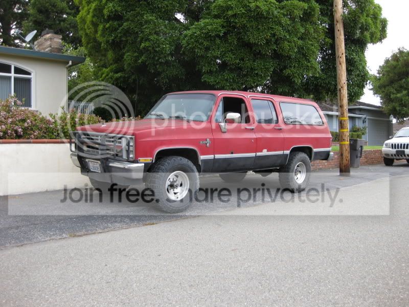

Major clearancing needs to be done if your wheeling it, this is my buddies which was good enough for dd duties, but rubbed if you hopped up a curb. Still needs about 2-3 more inches of metal removed form the wheelwell near the cab on the front.

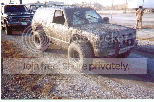

i fit 35s on a 85 s10 with no lift so a fullsize should be easy
never mind the guy in the background lol
Is there still room to trim? I dont mind trimming if I can do it. Your buddy's looks good.

you can trim more, you have to cut the inner fender back, then cut the the fender back to the cab and only run one bolt at the bottom of the fender. My truck is cut to the one bolt, and the cut goes right thru the washer on the one bolt.
