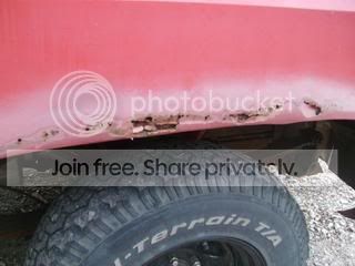

I don't know if this is crazy or not.
I have been saving towards putting 33x12.50 BFG KM2's on my '73 K5, which will fit with a slight fender trim.
However, in the near future I am planning to do a rocker box delete, integrate sliders, and replace floorboards like colbystephen's did to his '73, and also cut 3-4 inches out of the fenders. (Mostly to get rid of rust/bondo, but also to increase clearance.)
If I try to run 35x12.50's after that 4 inch cut, what other clearance problems would I have? Will steering/suspension components rub and/or bind? Will the inner fenders need to be reshaped or trimmed as well? I'm trying to figure this out so I can decide whether the order will be tires then metalwork or vice versa.
The KM2's are the same $$$ for both the 33 and 35, and I don't want to drop $800 or so for the 33's when I could have had 35's.
This may have been covered before, and if so I apologize, I haven't mastered the art of search yet:wink1:
From what i remember, bushwacker cutout flares leave enough clearance for 35's stock, so i see no sheet metal interference problems from the amount of cutting you are describing.
I'll leave the suspension issues for the more experienced.

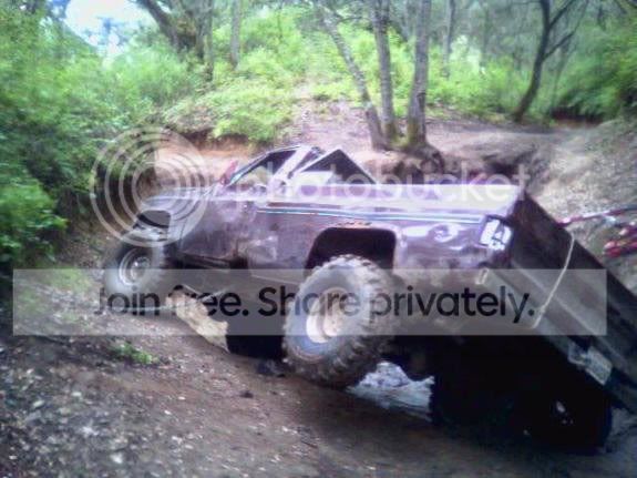

I put some 35's on my k-10 w/ no lift and sawzalled the rust off the corners of the fenders and wheeled it as is stock steering and all. Used the ralley 15 x 8 6 lug rims from a blazer. When I was tired of the cheap/bald set of 35's, I eventually put brand new 36tsl's on the same truck and they fit, if your fenders are already hammered from rust, you have nothing to lose and cut the rust off and slap some 35's on there.
here is a old pic of said truck on 36"tsl's.
not the greatest pic, but i was flipping it back over and this was 05ish.
now that i remember, i did break 3 out of 4 stock springs on that truck from the hell i put those stock springs through.
