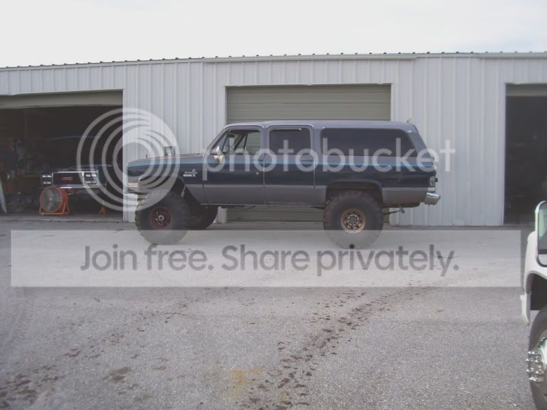

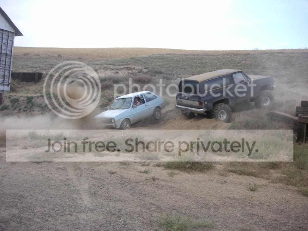

Off the shelf 4" Tuff Country HD springs in the front, shackle flip in rear with stock springs and shackles, and of course fender trimming but nothing too radical. Tires actually rub the top edges of the fenders front and rear slightly under extreme conditions but I modded the sheetmetal to prevent it from cutting the tires.

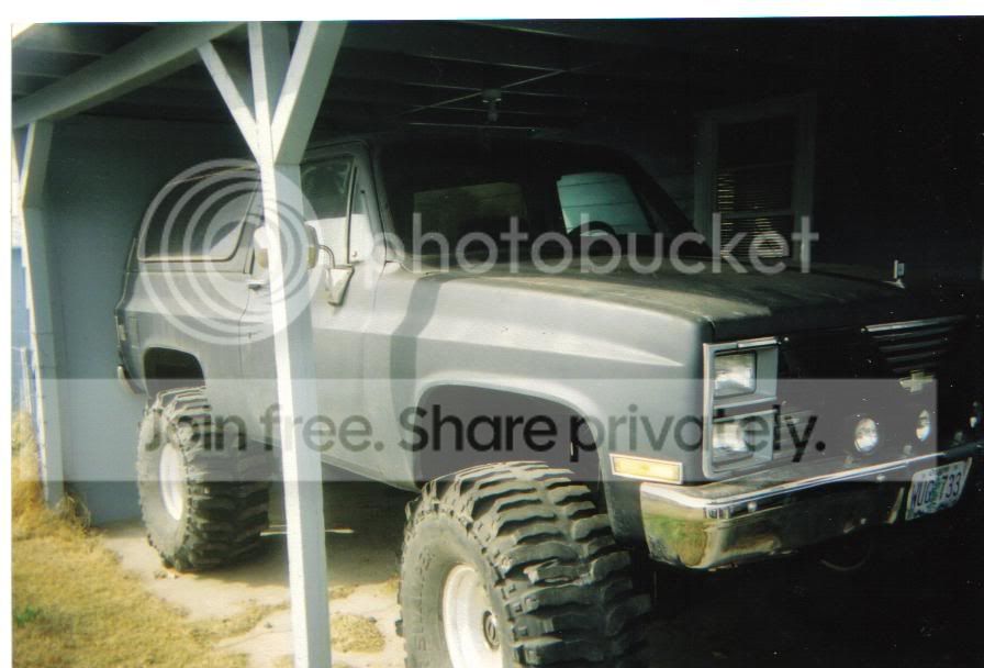

I have 39.5/15/15 on my stepside,(d60,14bff) 8inch suspention and 3 inch body(8inch front superlift softrides, diy4x shackle flip, 6in shackles, 3in springs) and when wheeling they rub when turned slightly even with cutout fender flares(not big on the fender trimming idea)....heres a pic with eaton 15x10s 3 3/8 backspacing

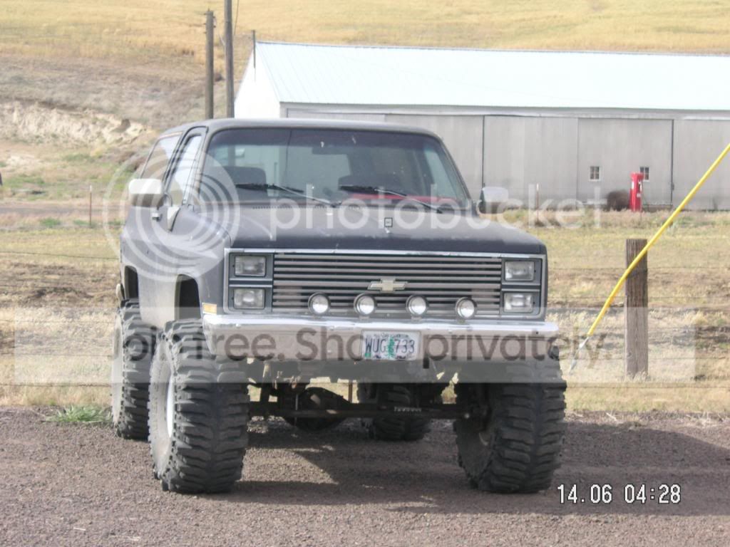

Heres 5" up front, on my extended blazer

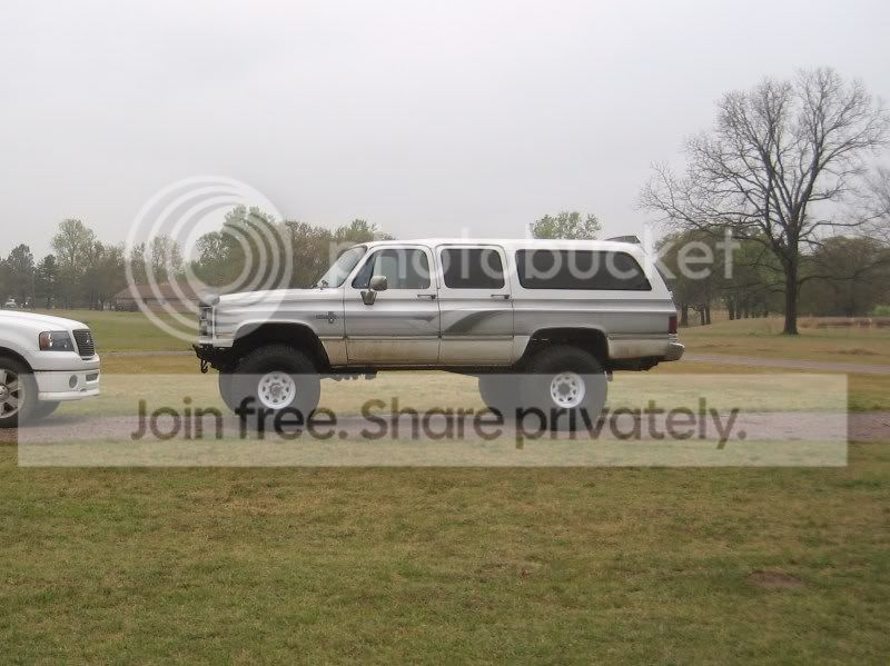

Mine is an '89 K-5, 4" all spring lift from pro-comp, 15 x 10, 4.5" backspace,
38" x 15.5 nitto mud grapplers. Moderate trim up front, will still bite on big flex.
