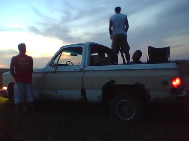

Pardon the crappy cell phone pics, but here is the "3rd row seating" in my 1985 K5.
Martin

:waytogo:LOL! While that works great in many cases, im looking to be a little more child/street legal friendly. I have an 83 K5 that I have considered selling to get a suburban so I have more room for the family. I decided why not just add seats and keep my dependable K5 that I already have put money into and not start all over again. I have looked at a lot of suburban's that people are willing to trade but my K5 is much cleaner than any other subs I've looked at thus far. So any ideas for "Real" seating would be great.
