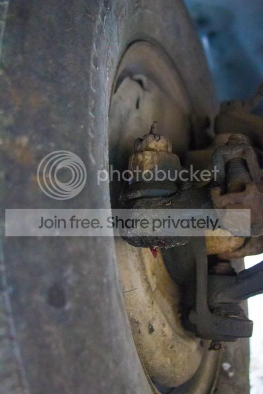

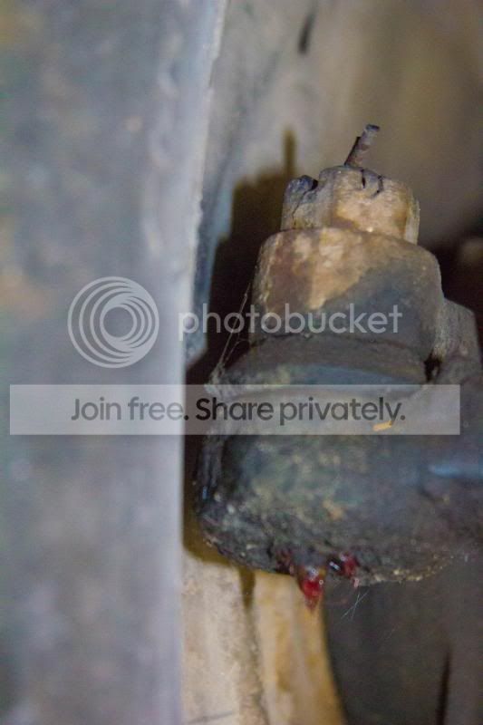

I just went out and popped my head in to the tire well to see how much play I have. From the looks of it, I don't even have half an inch of space left before the tire hits the tie rod spindel with the stock rims. How could that be?
EDIT: Added some pictures.
Factory 15x8's had 4" of backspacing.
I ran 16x8's with 4" of backspacing on my '89 with no issues. I think that 4.5" of backspacing would give you issues as you saw.

Thanks so much man, exactly what I was looking for. I'll toss some 4" on it and call it a day. I appreciate you taking the time to help me out.
