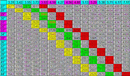

i forgot where i found this.....the chart is for 1:1 ratio transmission. yellow is for fuel economy, green is stock like and red is for power.
And these RPM's are at 65 MPH. If you're running a 700R4 then you need to multiply the RPM by .7 to come up with the correct RPM for OD.
