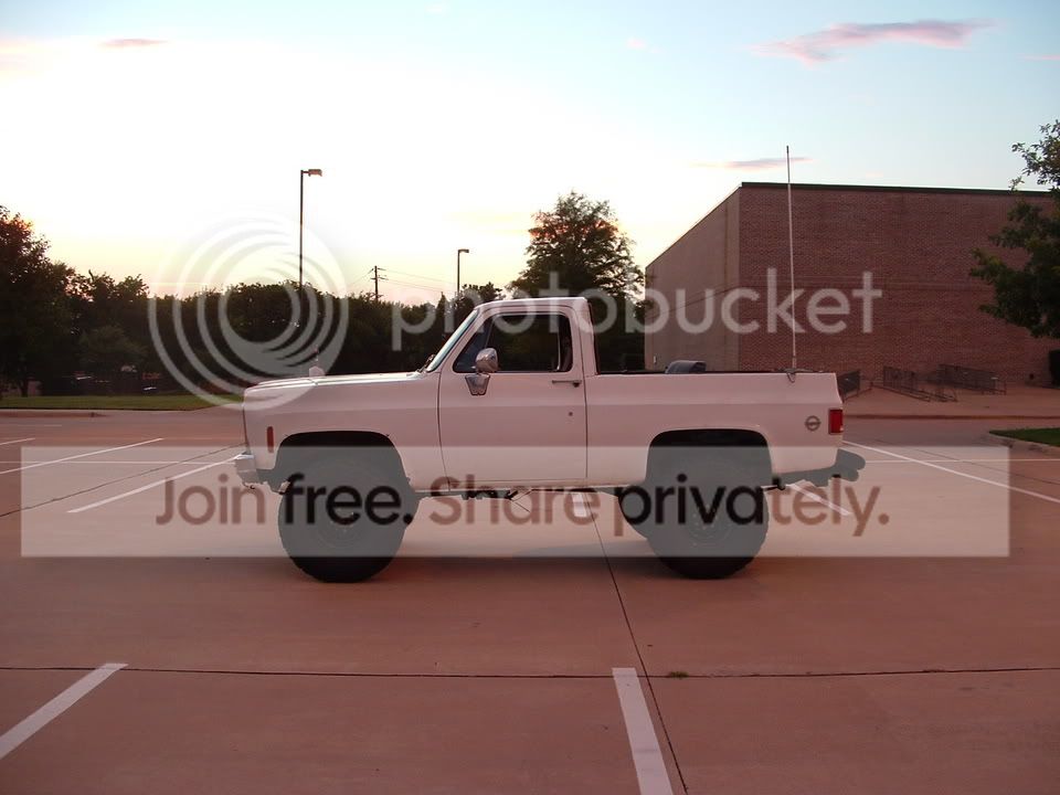

here's my 79 with 4" lift and 37x1250x16 ssrs on 16x10's
ive only done enough trimming to clear on the street so far. ive basically trimmed back to the inner fender on the front and rear of the front fenders. haven't touched the rears yet. i know ill rub when i leave the pavement so ill be doing good bit more soon.
