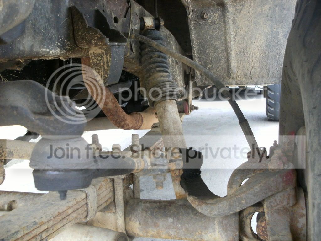

Heres what it looks like with a 4" lift, stock brake lines, stock steering arm...you can adjust out your drag link, a little bit makes a big difference. Don't go too far though, if your not sure go to an alignment shop and have them show you(thats what I did). I'm sure that if you buy a kit that it comes with a steering arm, I don't know why this truck don't have one...maybe too hard to get the old one off lol :confused:
