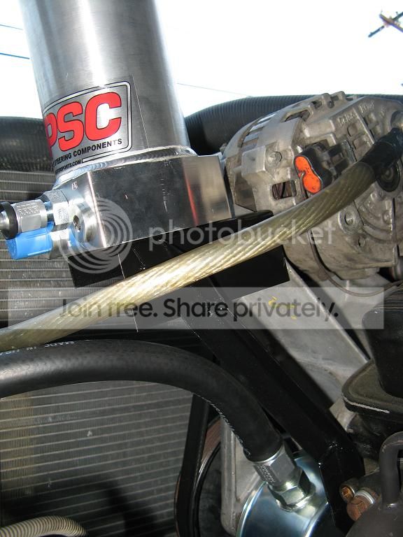

The plug on my 89 alternator is a PLFS type but only the F post has a wire. The outside of the plug has no holes where someone may have removed the other 3. I'm putting a high output CS alt in and read about the remote sensing wire being needed for true charging. Could this plug be an adapter for a 1 wire alt that someone used on the motor? (It's a transplant) On the lone Battery post instead of 1 wire going to the POS battery terminal it also has another wire that hooks up to a junction on the fire wall.

This is a factory plug. I pulled the serp brackets and all accessories from an early 90s newer body style truck. Just so you know. And I rewired my truck, ended up using the exciter wire hooked up to the alt. I don't know if it's right LOL, but it works. I too would be interested in knowing what I need to use in order to use the larger CS144 alternator. I already have an adapter bracket for the larger body.
Yep thats exactly what I've got. Mine's an 89 serpentine setup in an 85 'burban. So is that lone wire in the plug your exciter? I guess the remote voltage sensor wire isn't a big deal since it's been charging OK all this time.
