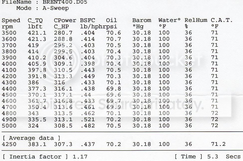

Just throwing this out there. To compare your options, rebuilding an old engine VS going with something like an LS motor. The dyno run was not for tuning or performance gains, it was used purely to break in the cam and check over the rest of the engine. I will be installing a FAST EFI setup and would not be able to break in the cam properly. Not sure how much better it could get, just happy to have a finished engine. :woot:

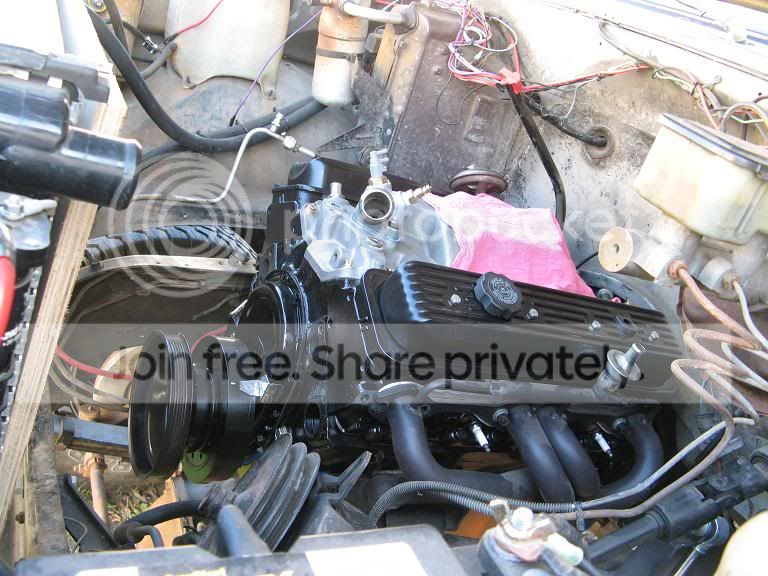

This is my 406 small block. I don't know everything about it, but I know some. It is still a smog motor, so I didn't go crazy on it at all.
'78 406 small block
'92 TBI heads with Vortec style intake runner, but not Vortecs
2.02 / 1.60 valves
Standard rockers
Slight dish pistons
9.3:1 compression
Stock crank and rods

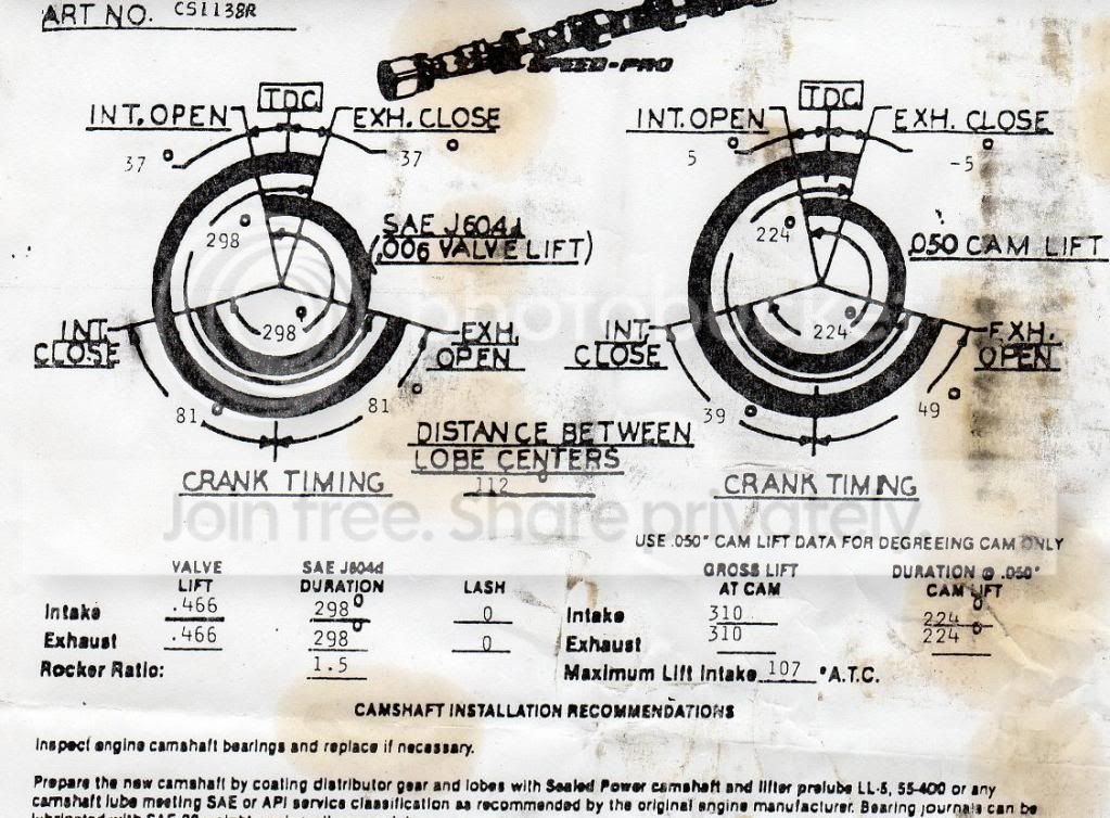

Speed Pro cam (specs below)
Dyno sheet says he used a 2" spacer (:dunno:) timing set @34, used 92 octane. I think idle timing was 15*.
Cam specs and dyno sheet
That's pretty cool so looks like it maxed out at
317hp and 421lbs of torque
Is this to the wheels? That's pretty dang good I think they say 27% power loss through the drivetrain is conservative.
So that things making some pretty good power at the flywheel. I hope to get my 383 on the dyno soon.

nah, it was an engine dyno. Still working on getting the truck running and put back together.
Still nice numbers. I'm hoping for 350hp and in the 400's for torque.
I dont have all that smog stuff. Mine still passes a snif test
Your 406 is nearly identical to mine, except your cam is a hair bigger and I still have the stock heads. I ran mine on a dyno and made right at 200HP/300ft lbs, at the rear wheels. The dyno shop figured I was right at 300HP and 425ft lbs or so at the crank. The difference with your motor, likely due to the slightly better heads and cam, is that you are still making power into the upper 4000rpm range, mine drops off like a bag of bricks past 4K. But, it rolls in strong starting at 2200 or so.
