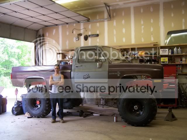

heres my gal
83 chevy k30. 496/4500/205 on 42" tsls
suspension is rear: diy shackle flip. 4.5" shackle. 4" tuff country spring roughly 8" total
front are skyjacker 6" softrides, 1.5" shackle, 0 rate... roughly 9" lift
this pic was taken with no drivetrain so the suspension has not completely settled (body off restromod) ill post up 2 pics for yah, and the fenders werent cut at this time either
im 5'6"

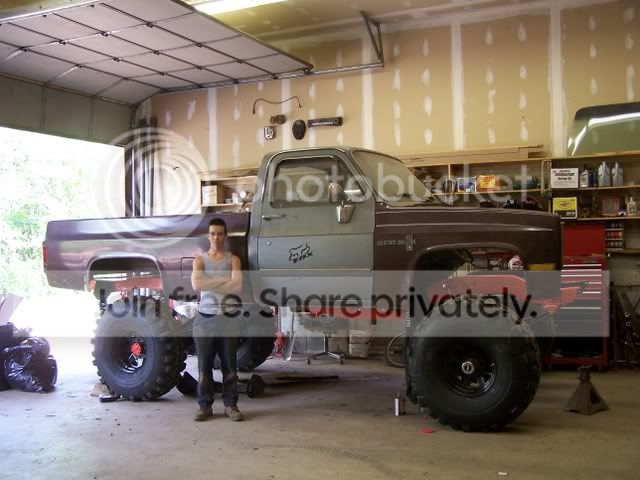

first one is with the body lift 3"
and this is how tall the truck will be (no bl)

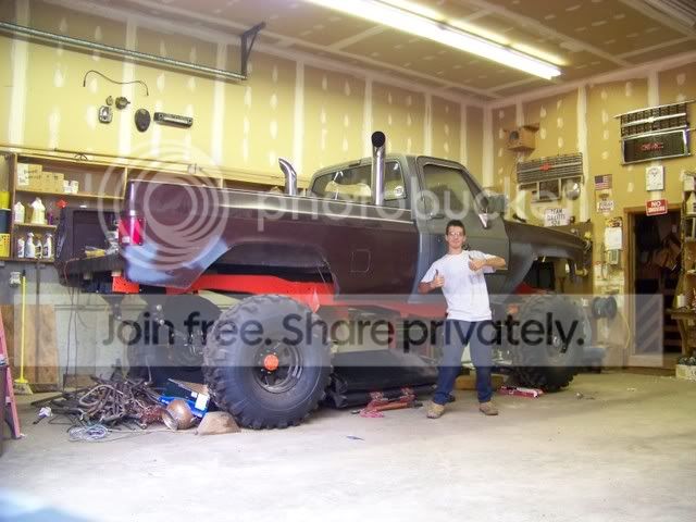

this one is with bl... yes i am running the stacks

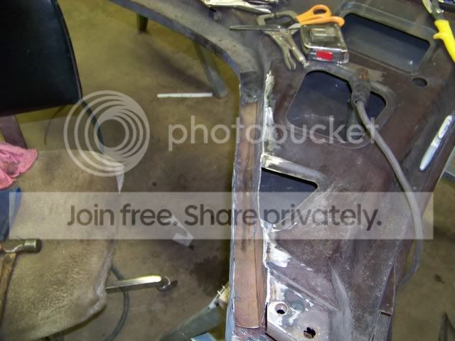

you can see how much i cut my fenders in the last pic

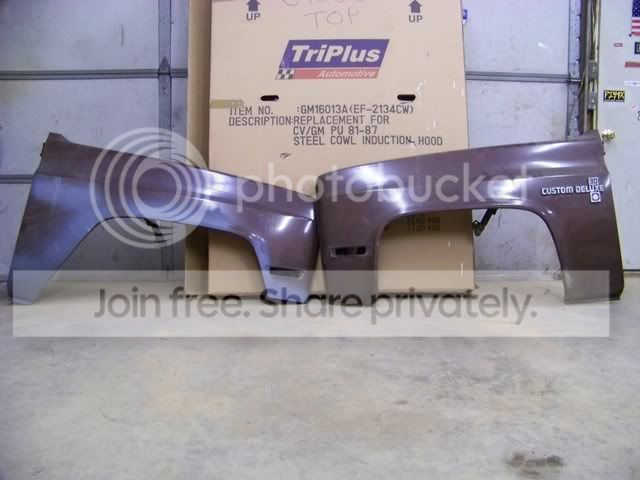

Thats my prob, im going to do the body all over on my swb. I have a cowl hood, fenders, doors, rockers and cab corners done last year...and then it will be painted. Id hate to get the tires and them rub too hard...i can get a deal on em and dont wana pass it up.. I dont mind cutting the new fenders for new cuttouts but i dont wana chop anymore than that, i have 37s now and lots of room...

the fenders look good, i dont wana go that far with them. just cut outs and flares. nice work tho....

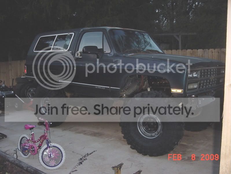

Here's mine...
Front = 2.5" lift 52's (currently without the overload spring) - approx 6" lift
Rear = 4" lift 56's + 2.5" flip + Zero Rate
1" body lift
Tires = 43" SX's
There's about 2.5" difference in height front to rear so I'm planning on adding a Zero Rate to the front and possibly putting the overload back in.
