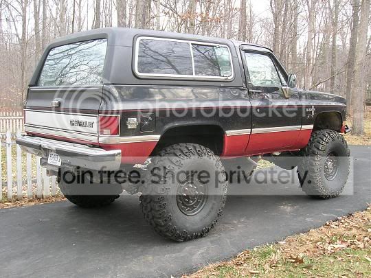

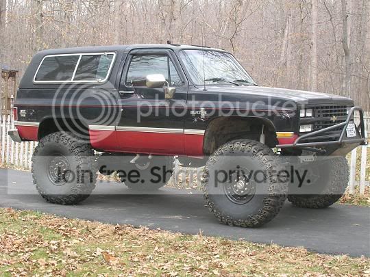

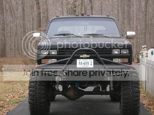

shackle flip, zero-rates, and a combo of leafs from 2 packs of stock 64" chevy springs. stance is about 7-8" lift. heres a pic with 42's for reference:

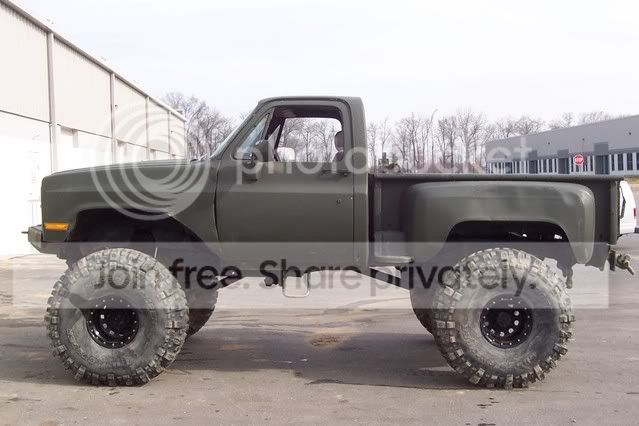

I know it's not a Blazer but....8" lift and some cutting.
And yes you can make it flex.....:D
