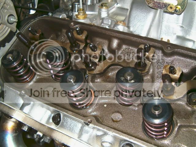

here's a pic of the CC eliminators on my heads....springs are from K-Motion.
I support CC stuff as well, good folks to work with.
not saying your wrong but what is that undwer the ex side springs ? and not under the in springs ?
BBC's use exhaust rotators like the SBC does but instead of being a rotator retainer like the SBC they are just rotators that go under the spring and all of the retainers are the same on a BBC. The intake springs on a BBC use a shim that is about .015" thick under each spring.
