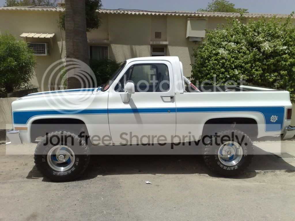

Hi guys its been a while, im just in the middle of a big block rebuild , ive brought a couple of large rectangle port heads as my 781 heads require some strange spring set up , trying to get parts here is tuff! so as i said ive got large rectangle ports and a matching intake,is ther any problem fitting these heads to my block as i think they are gen VI heads for a 502 , someone mentioned that the water holes are different ? is this true ? They do seem a lot bigger than the peanut port head water holes, will i have any future cooling issues? Im thinking to put a 292 cam and lifters in also to liven things up a little :D
