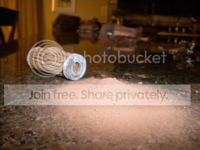

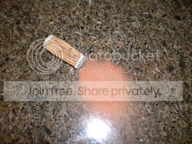

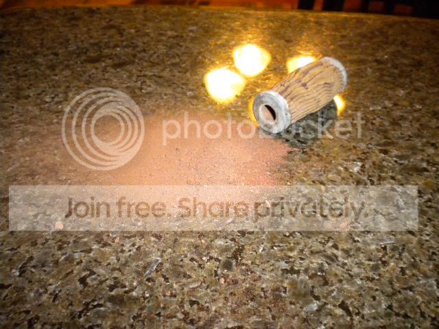

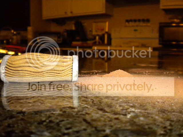

while i was in there i found this. im pretty impressed at the capacity.
holy crap, I've never seen one with that much in it.
I hope youre going to disassemble the carb, those filters will unseat if clogged so it will still run but push that junk in your carb.
I just read this, I was going to suggest fuel filter but you already caught it. I had the same thing happen to me. I would just put in a new filter and run it, if goes great just leave it as is.
Wow that's a lot of sand.:doah:
Ever thought of dropping your tank? Seeing that filter plus a new fuel pump makes me think your tank could use a good cleaning.:crazy:
hats crazy.how long was that filter on there?doesnt look good.there should never be that much crud runnin through there.no wonder your engine was choked:eek1:
You need to run another fuel filter inline on the fuel line as well. The carb fuel filter is a weak filter to be used as the only filter. You must also have some contaminates in your fuel tank as well, in order to have that much debri end up in the fuel filter.
